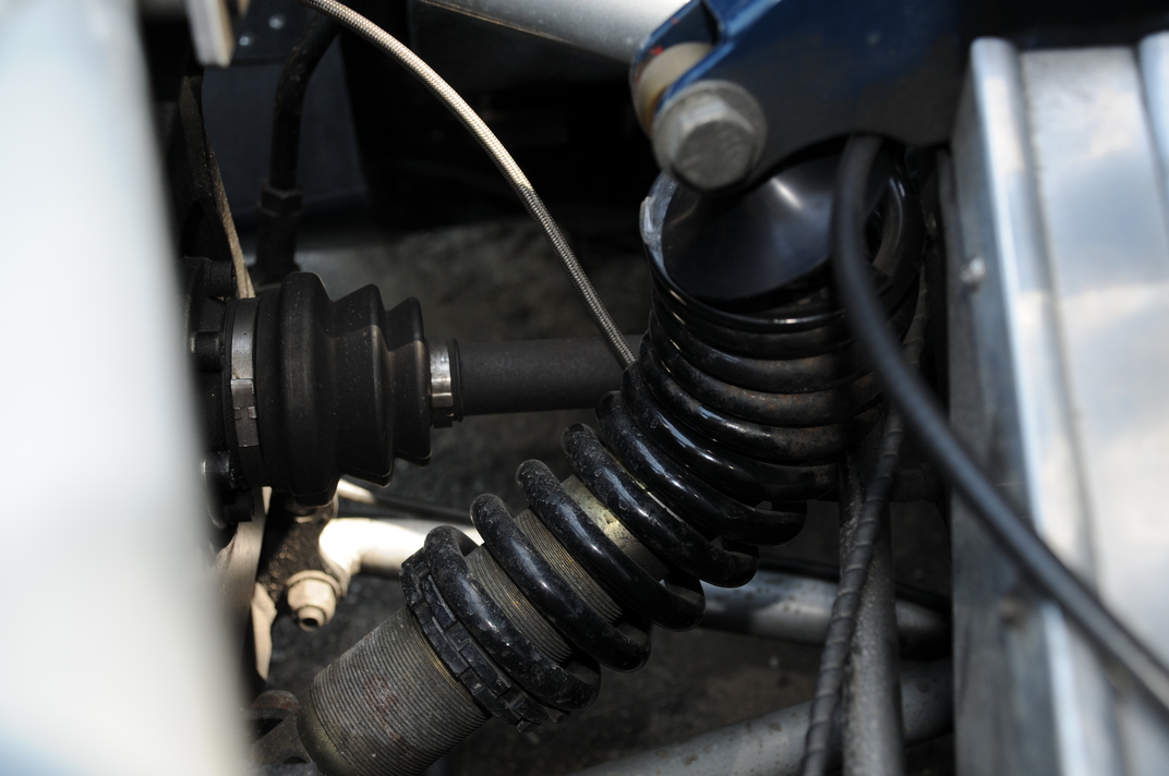

Unfortunately the quality of the roads is not very good. About 35 km before reaching Frank's place I heard a loud clunk and the gear lever was completely stuck in position. Not a single movement possible:huh:
My first thought was a gearbox breakdown, but how/why?? And no rattles?
I let the car roll to a safe parking spot and opened the rear deck. Then I saw the problem, the shock broke and the spring caught the gearlever-rod.
So a bit happy that it wasn't the gearbox, but I was still stuck in what appears to be about the middle of nowhere.
I called Frank and told him about my problem. After explaining him where I was (which wasn't easy...) he and Jeff came to pick me and the car up.
After arriving at his workshop and having a lunch we started to have a look at the car. First of-course the right rear shock. After getting the shock and spring removed, the problem was that the top cap had become unthreaded.
We ordered a new cap, which came in a couple of days later, problem solved!
