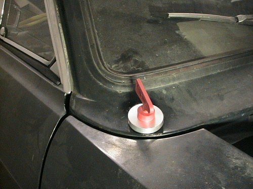

Battery cutoff switch replaces radio antenna.

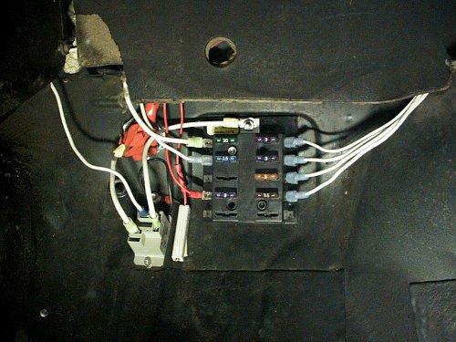

These cars came with no fuses /ubbthreads/images/graemlins/flamed.gif I added a fuse block for safety & a relay so that the only current that passes through the ignition switch in the ON position is the power to the relay. Headlights and starter solenoid remain unfused /ubbthreads/images/graemlins/shocked.gif
This is mounted on the firewall in the passenger footwell. I need to make a cover for it so it doesn't get kicked.

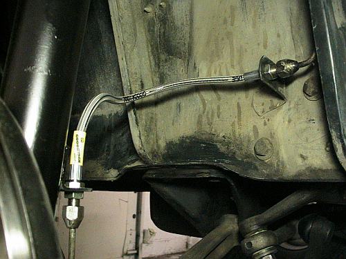

Goodridge braided brake pipes. I got these from Burton Power in the UK. They are DOT approved.

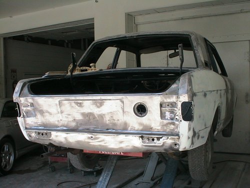

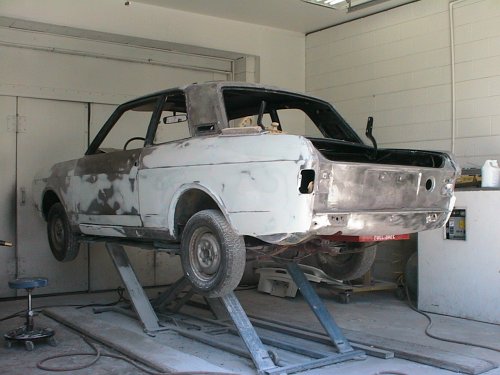

In the shop for body work & paint. Maybe someday it will be back on the road...

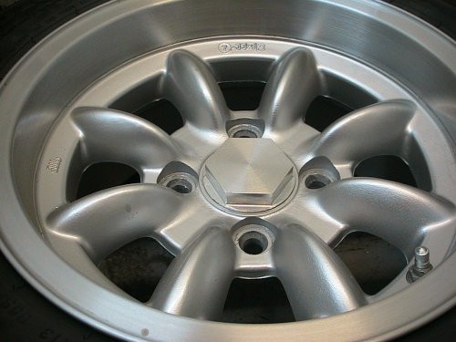

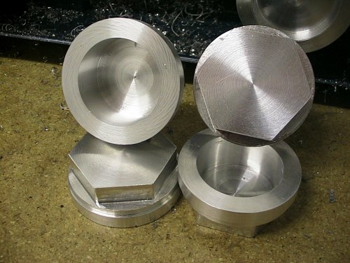

Wheel centers. These still need a bit of finishing and polishing

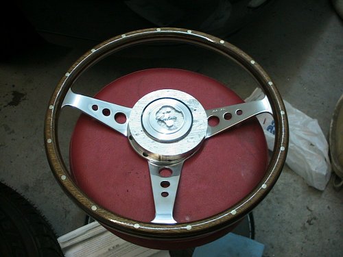

Motolita steering wheel (Hey, if Clark Gable could replace the steering wheel in his 300SL with a Nardi, I can put a Motolita in a Cortina :p)
It might be hard to make out all the pieces here. There's a chunk of raw aluminum there that I'm going to machine to hold the original emblem (sitting on top, and needing a bit of restoration itself). This will replace the supplied ring (not shown) which may be the correct size for a Motolita horn button, but the hole it has is too big for this emblem...
