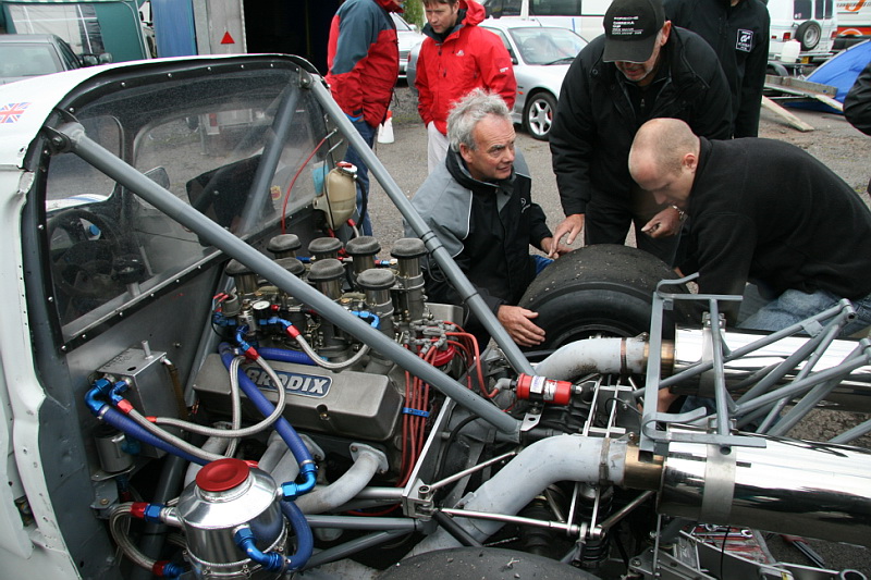

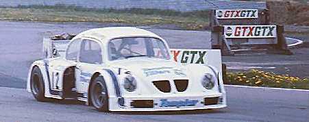

You might want to have a look at Mick Hill's V8 beetle supersaloon which ran in special saloons in the 70's. I saw it run back in the day at Oulton Park. It is still around today and has been seen recently at Mallory and Goodwood.
VW Beetle Hill/Wilson
Recent outing with other special saloons from the good old days when cars looked and sounded different and were actually interesting.
[ame=http://www.youtube.com/watch?v=G2z7-wuuWfo]Mallory Park Modsports & Supersaloons 290811 - YouTube[/ame]
