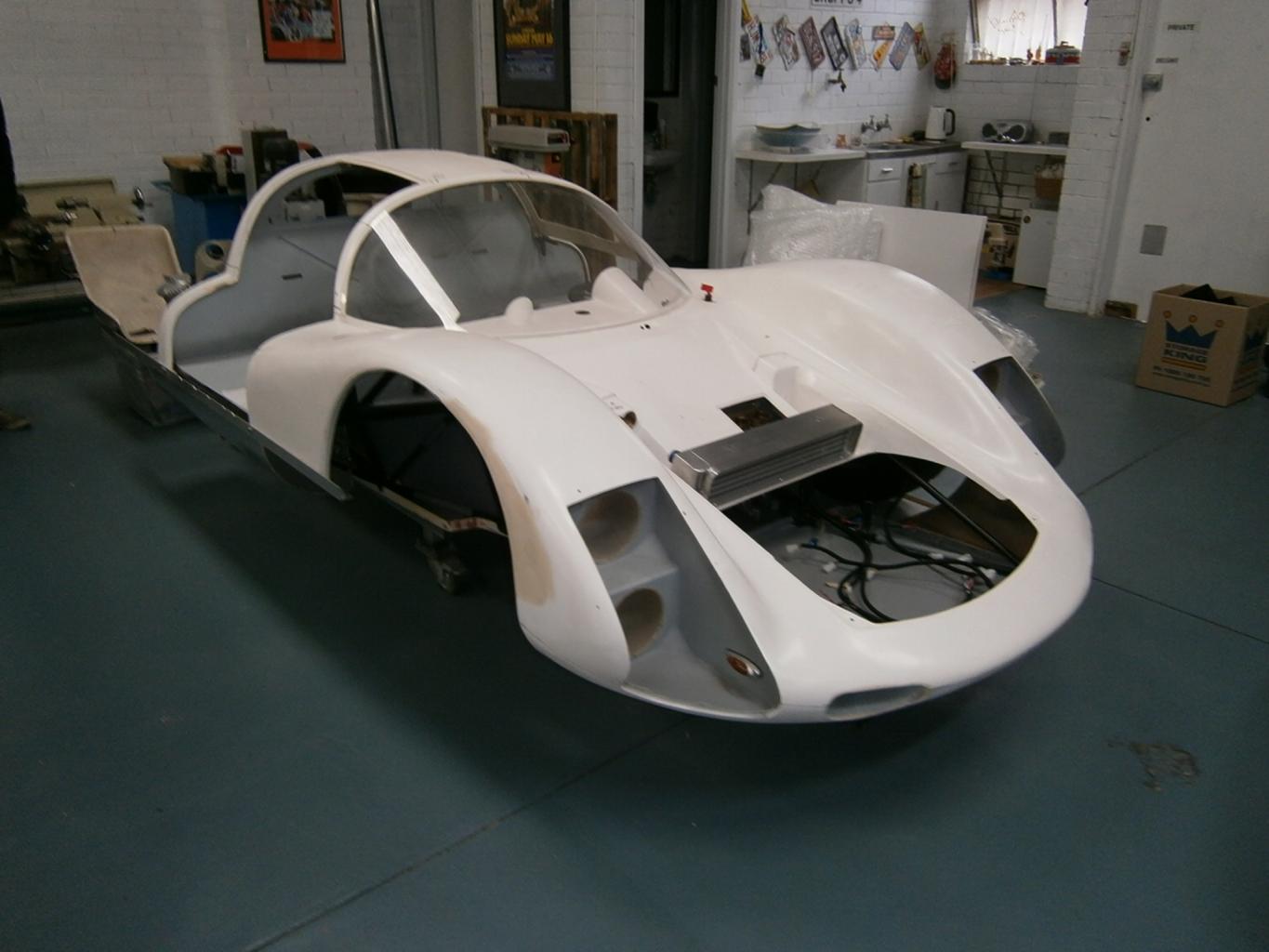

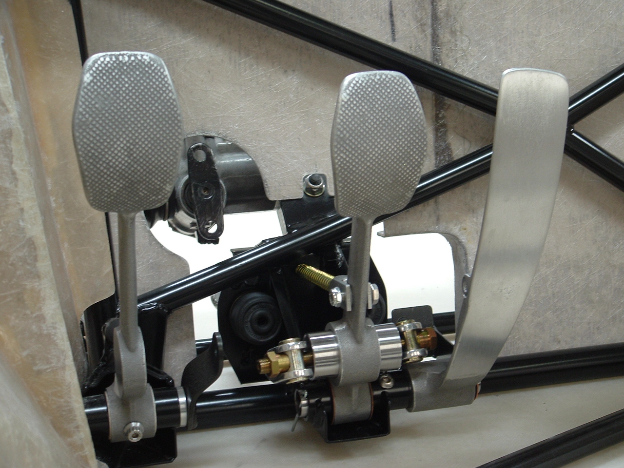

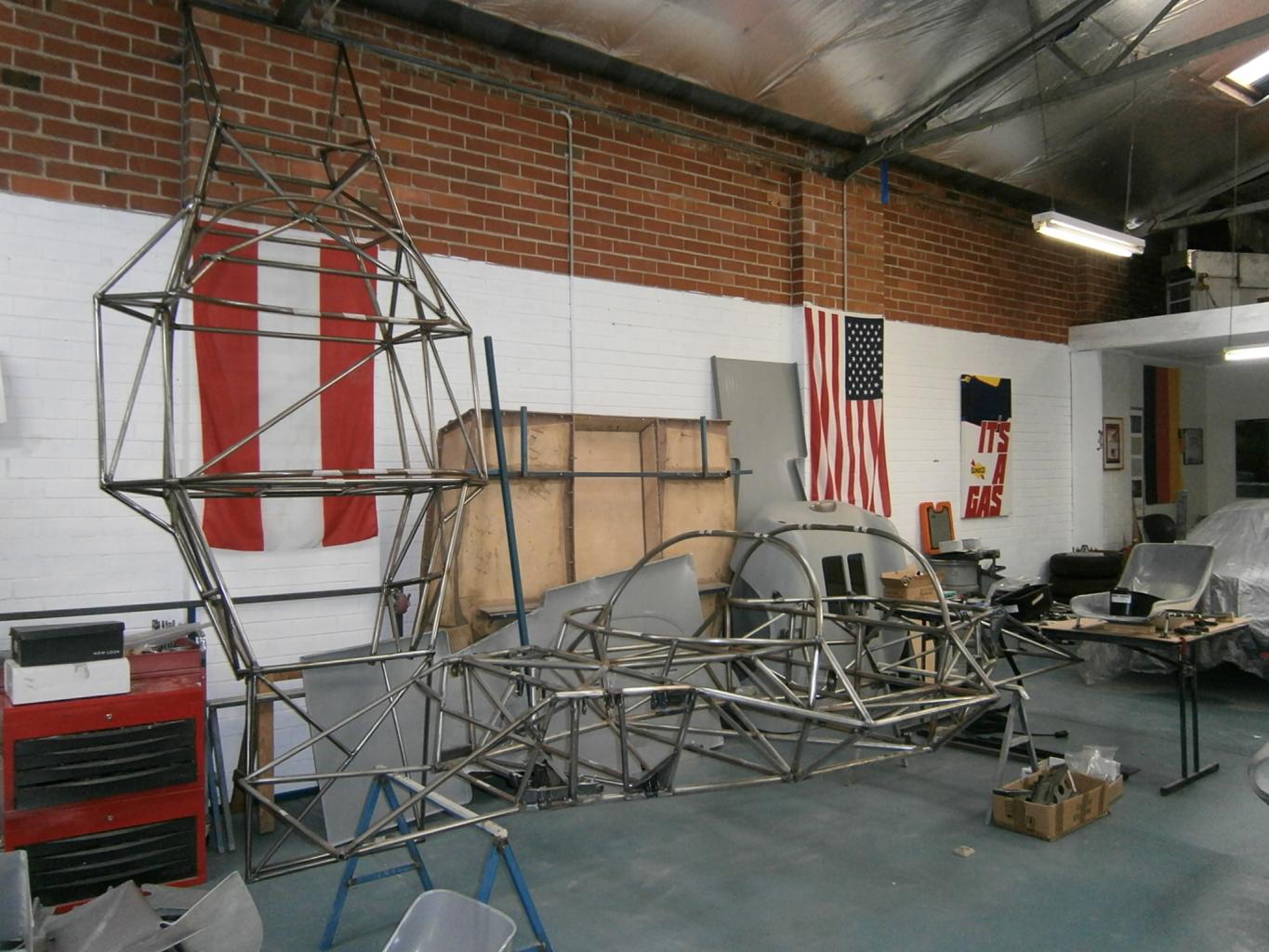

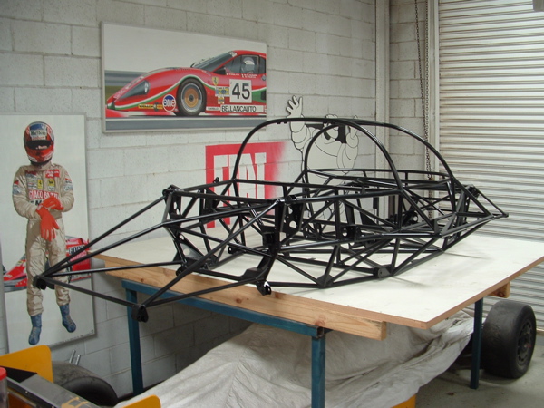

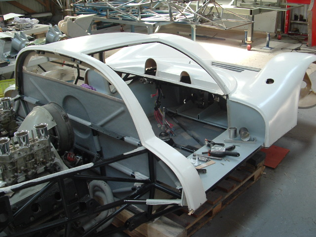

The original 906 were tube frame. If you're looking for a 906 replica, we have them. Go to WerkzCarsDotCom.
Randy

Yes, the USA... and the rest of the world.
Eight 906s have been purchased so far as well as twenty-six 917s. The first two 906s will be in Los Angeles at the end of the year.
Randy
