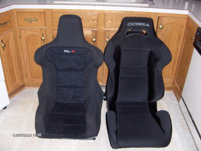

I've attached a photo of the RCR seat (upholstery has not been attached - just draped over the seat) next to the Cobra Daytona. I just received the seats and need to try them in the SLC to see how they fit. I'll post a photo or two of the drivers seat (the one that matters!) in the car tomorrow and I'll let you know how it fits.
Dave L

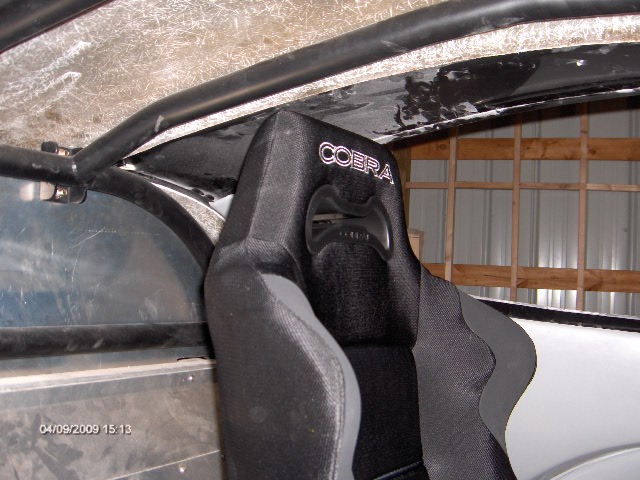

Doc - The Cobra seat is VERY close to fitting perfectly out of the box. I'll post some photos a little later.
SLC seat dimensions (base flat on the floor):
Height = 33.5"
Width = 19"
Depth (total) = 22"
Width (shoulders - max) = 22"
Width (waist - max) = 17.5"
Headrest width at top = 6.5"
Headrest width at top of seat back = 9.5"
The Recaro Sportster CS is a beautiful seat - but it won't fit. Your dimensions are a bit off based on the information I have. The backrest height from the floor to the top of the headrest is just over 36" - WAY too tall. And the plastic seat back would make modification troublesome. Take a look at vividracing.com for a dimensioned diagram.
Dave L

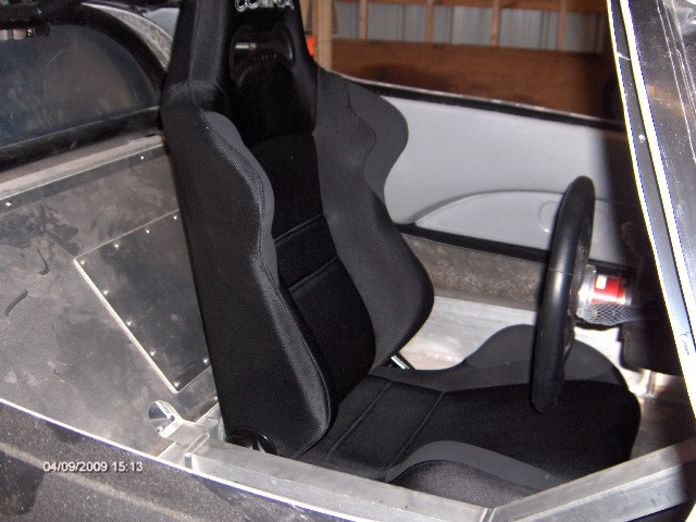

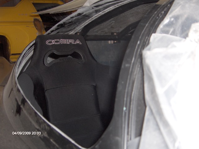

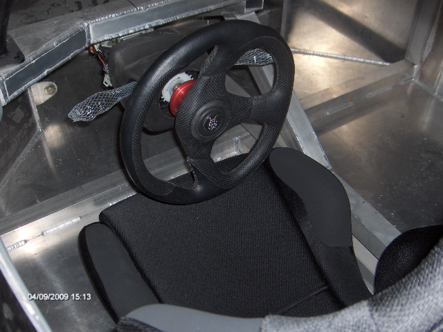

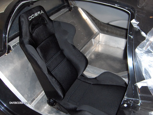

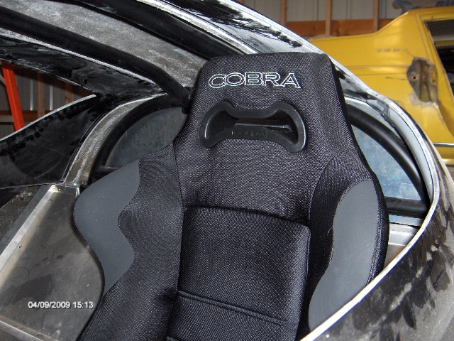

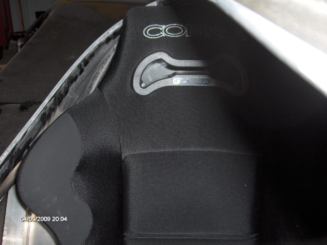

I wanted to double check the fitting of the seats so I temporarily fit up the door panel to be sure there are no interference issues - the seats aren't even close to the lower part of the doors. The one clearance problem is the width of the upper part of the headrest. A little trimming by an upholstery shop and the seats will fit fine. Keep in mind with the following photos that the steering column is adjusted straight and all the way out (it tilts and telescopes).
Dave L

Dave,
I am all jealous to read the measurements on this seat, reads like it should drop right in. Seems I remember that you are a couple inches taller than me, if true I am confused by the apparent proximity to vertical of the seat back position. With my seat and my (lack of) height the seatback more or less blends in with the slope of the back of the side glass opening. If you have not already done so may I suggest checking the fit of the passenger seat as that seat sits more outboard the centerline than the driver, meaning that any shoulder/headrest/roof clearance will be tighter.
Nice starting place
Rob

Hi Rob - I was hoping you would offer your insights on this topic since you are further along than many of us. The seat back position in the pictures is just what I happened to have the seat set to when I took the pictures. The seat back is capable of tilting forward and back from the position shown - the only clearance problem is the outer corner of the headrest against the window opening. You got me worried with the passenger seat so I rushed out to the pole building with a seat to check the passenger side. While the shoulder bolster is tighter to the door, it fits! The headrest is still an issue as shown but that is an easy fix. Thanks for prompting me to check the passenger side!
Dave L

Doc -
Good luck with your search, I checked Recaro, Cobra, Corbeau, etc. and while some are close most will not fit without significant modification. Let us know what you come up with.
On a side note, I was AMAZED at how well the innner door panels fit the doors. I wanted to be sure there were no clearance issues between the seats and the doors so I just taped the door panels into place - virtually a perfect fit on both doors. Really amazing for fiberglass parts. Well done RCR!
Dave L
