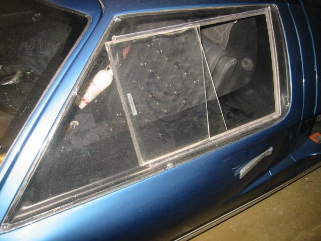

Bernie,
If you are still around.... this is what my KVA was wearing when I purchased the car.
Howard Jones
Lexan can be glued so effectively that a "rail" can be made by layering three strips together. 3/4 inch then 1/2 inch the 3/4 inch all 1/8" thick will leave you with a "rail" 1/8 inch deep and 1/4 inch wide.
Then line them all up with a common edge and drill through to secure to window. A frame can be made by cutting the ends at 45 degrees and gluing it all together. I can think of many variation son this type of design at I type this.
