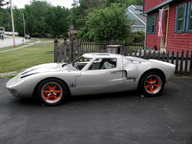

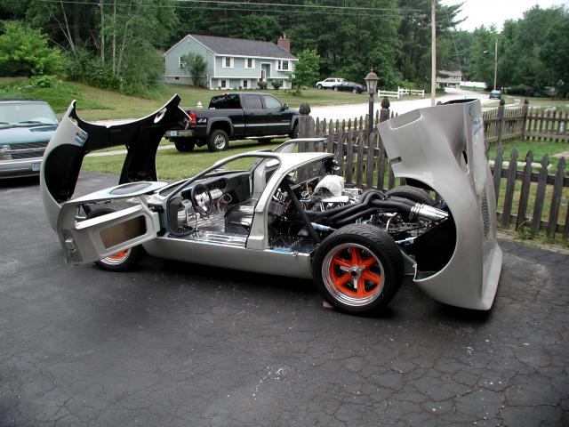

I know it will never be confused with the higher end replica, but having bought probably every used and surplus GTD40 part in the UK plus those in the States, plus the parts I bought on EBay, have hade made, have made, borrowed, begged, have been given as gifts and exchanged for favors, I'll probably have somewher in the low 30s into mine when it's on the road.
Brian

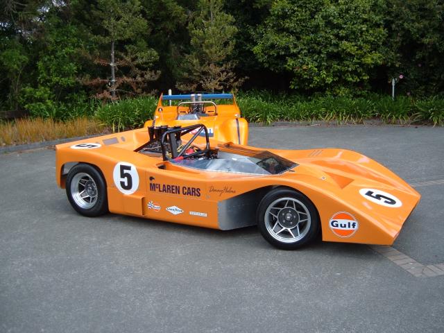

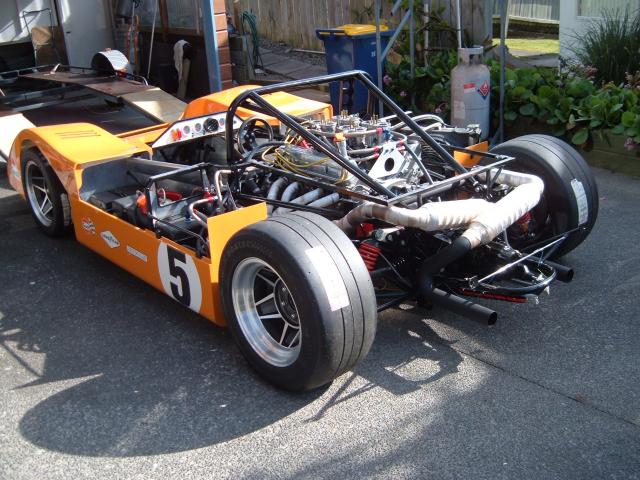

For a totaly different take on costs, when the knockers say `that must have cost a fortune` I tell them that it cost less than the average drinker / smokers spends in the 5 years that it took to build. At least if I am `pissed` with the results at the end, I still have something to show and sell.
In reality cost is only relevant to income.
Regards
Russell
Mike Pass
One of my all time favourite cars. Excellent work Russell - a real credit to your efforts. You have got to love those trumpets sticking up into the breeze. I really like the look of the original cars with the giant odd length multicoloured trumpets. I have a video I took at Silverstone with two M8s and 15 Lola T70s doing a rolling start - the noise was fantastic! You can't really beat 850hp in a car the size of a roller skate.
