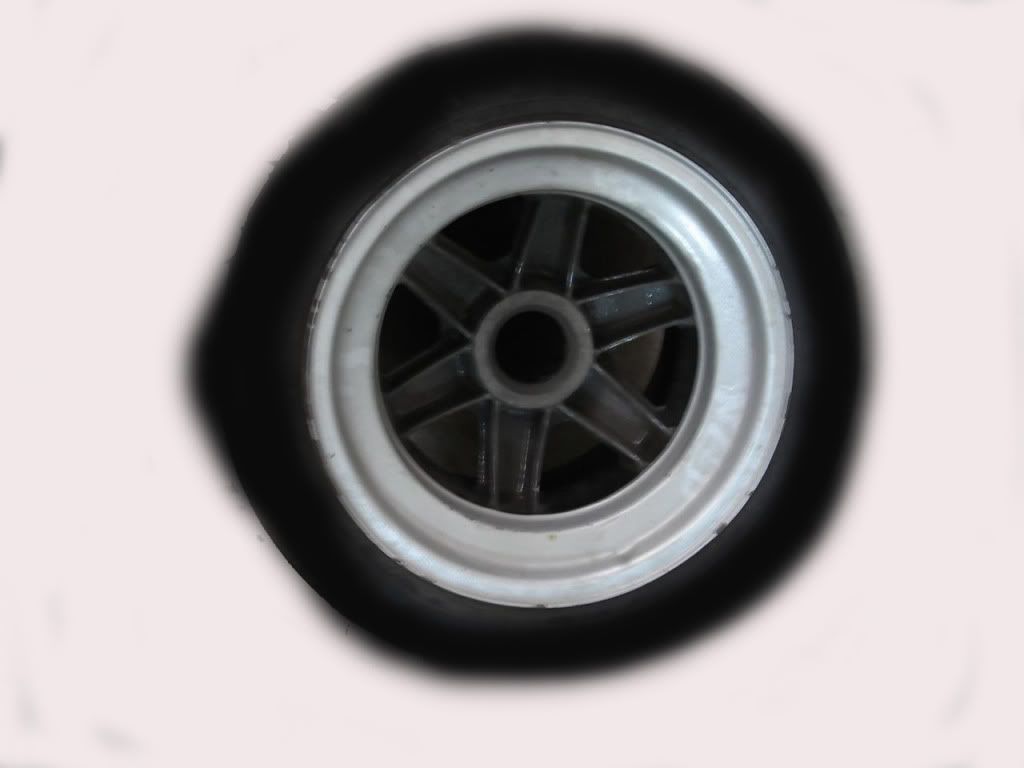

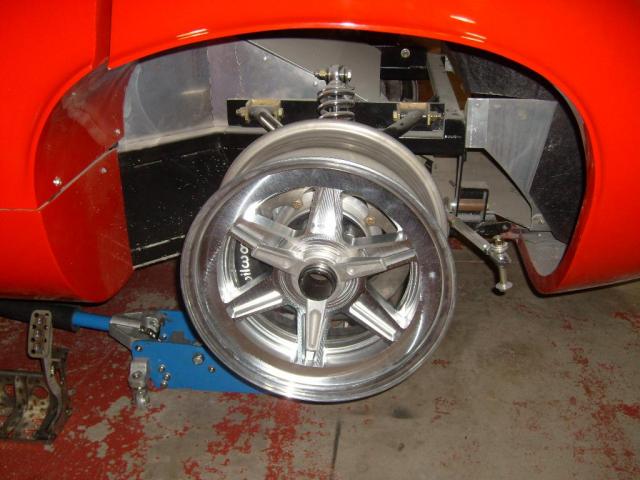

Have had the tires fitted today. 5 Minutes and they where done. No issue at all.
the section added is still much smaller in dia than the original "HUMP".
added section
some pics with the rubber on it

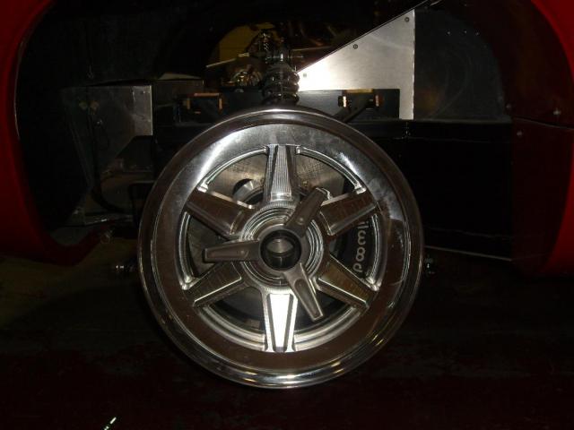

I am wanting my GT40 Halibrand reps 'deep dished' at the front and have emailed that company in Germany today.

ps basically my wheels are these:-
And I need to get the 'dish' of the wheels to resemble these:-

Yes i have widened my rear wheels by them. The processed the wheels withing 3 weeks. Very nice and exact work. Have not done any additional cleaning, just off to the sandblaster and powder coater ( wheels are black now). They run perfectly true.
Have not driven them yet.
They do a lot of old style 911 Fuchswheels for RSR conversions. have a good reputation.

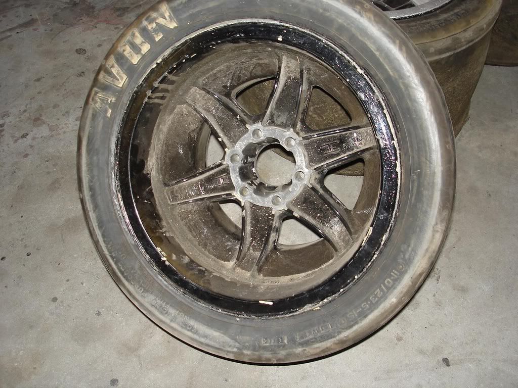

I have the Lola wheels as three piece on the shelf.....any backspacing or PCD

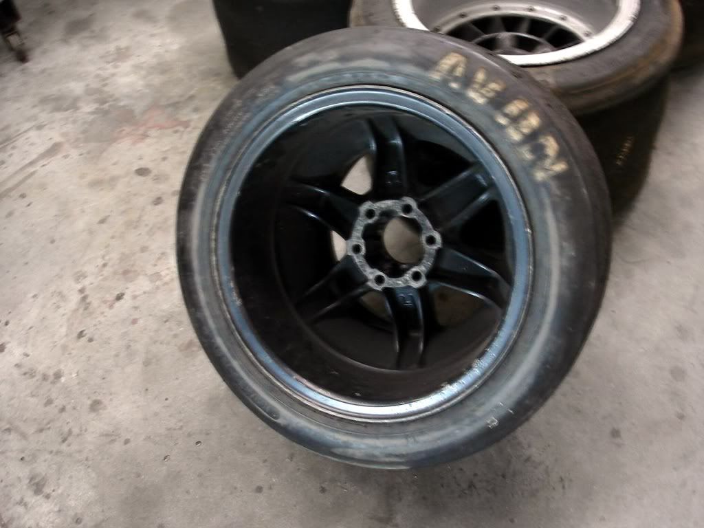

The wheels I need must look like these - they are the original Lola type on the car I'm replicating. Notice the curvature of the spokes.
If I can't get pretty much the exact profile of wheel I may as well get my Halibrands widened.
thanks Chris

They are not T70 wheels then....as the originals I have all have much straighter spokes...
We can machine you wheels exactly as you have pictured but to put that much surface contour into them will not be cheap, the billet would be very expensive ...but they will look right...
The price of correctness I guess....your call.
