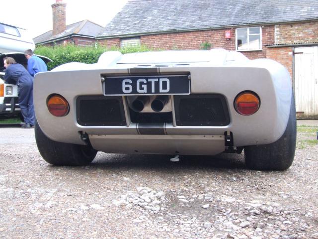

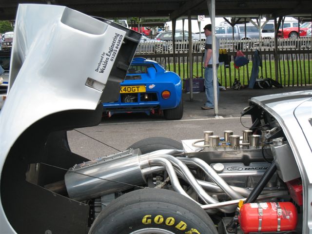

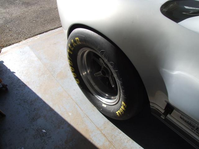

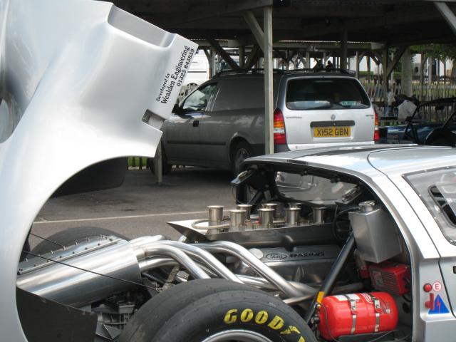

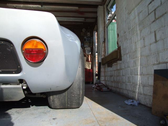

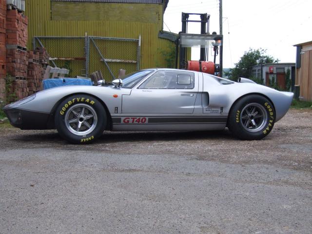

Fred, proper size slicks on 15 inch Vintage wheels ! Frank

Hi Fred, Martins car has standard GTD bodywork and standard vintage wheels dimensions (8 and 10 ) . The slicks are same overall diameter as original GT40 race tyres. If you want detail of my suppliers please contact me by E mail. Frank
