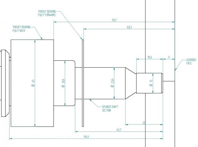

The attached picture shows the measurements I took tonight on my 012.
With the measurements as shown and the A6 clutch used there would be 2mm clearance between the thrust bearing and the spring fingers in their fully extended position. This would occur in the fully worn state for the clutch plate.
I've yet to determine how much clutch fork movement is needed to disengage the clutch. But the next thing is to determine that there's enough movement in the thrust bearing to disengage the clutch in the brand new condition.
All of the above is assumeing that the friction plate is only just fully engaged on the input shaft when new.
There is the possibility of adjusting out the bottom pivot point for the lever that operates the thrust bearing, by default it protrudes 20mm this could be packed out further if required by putting washers under it. But there's no way to get at it with the transmission attached to the engine, so that would need to be right bore it was all dropped in to the car.
All of the above is assuming that the friction plate is only just fully engaged on the input shaft when new.

Sounds like a great plan except I don't know what TOB stands for?
The 0.020" (~0.5mm) was the number I'd been worrying about, my uneducated guess had come up with 2mm. So thanks for that.
Hey Doug, a good mate of mine owns a performance clutch business in Osborne Park. If you're ever up that way, you should call in with what you've got and have it tested.
Oppps, sorry Doug. TOB = Throw out bearing like others said.
I just want to clarify something because I re-read your other post and I think I confused you with the dimension I was giving.
The .020" additional factor is a rough dimension that I add in to the total diaphram spring finger travel to allow some float clearance for the disk between the friction surfaces of the flywheel and pressure plate when the clutch is in the disengaged position.
Example: Say when you setup your particular clutch in the press and do the procedure I mentioned above and the disk releases freely when you have compressed the diaphram springs 1". Take that 1" measurement and add in an additional .020". Some factor in more clearance for this on a street type organic clutch setup for more longevity(upwards of .06-.08") This gives the disk enough room to freely spin between the friction surfaces w/o binding or dragging which would cause excessive heat and wear, however not so much as to cause a bunch of clutch chatter on engaging. Carbon or semi metallic race clutches grip better with more heat, but also chatter more as well thus the smaller .020" factor.
From your original post it looks like you're wondering what amount of clearance is necessary between the diaphram spring fingers and the throw out bearing pressure race when in a fully engaged position(no pressure on clutch pedal)??? Typically I like to have the TOB to lightly touch the springs, as this keep the rattling noise down and "feel" of the clutch right where it should be. Any sort of gap between the two said components and the clutch will feel smushy at first pressure until the TOB contacts the clutch diaphram.
(Another example, but for pull type clutches(porsche, sti)....a light spring is used on the clutch fork itself to provide slight drawback pressure. It's typically positioned in the vicinity of the slave cylinder on the outside of the bell housing. This keeps contact pressure of the clutch fork fingers into the throw out bearing lock tabs, but also provides some pullback tension of the throw out bearing against the wedge collar........the component in a pull type clutch diaphram that affixes the TOB to the clutch and pulls against the diaphram springs)
Hope that helps clarify a few things for you :)

Thanks for the above that clarifies the issues a lot.
I guess the problem I have is essentially a simple one and as usual I expect I'm over complicating the solution.
I'm using a stock Audi A6 (V6) clutch and slave cylinder in an Audi 012 (Boxster) transmission.
Due to wanting to keep the offset on the custom flywheel I need to get made to a minimum, I plan to have the friction plate only just fully engaged on the input shaft.
The problem then is to make sure that I will have enough movement left in the slave cylinder to disengage the clutch in its brand new condition (when the fingers will need to go in the furthest).
Having thought on the issue some more I'm sure that there will have to be enough movement as I'm basically using all Audi parts that were meant to go together in the first place and if not moving out the lower pivot point on the of the TOB actuating lever will fix any issue that comes up.
The Audi slave cylinder has a surprisingly strong spring in it that will keep the TOB against the spring fingers, so that will deal making sure that there is no gap there.

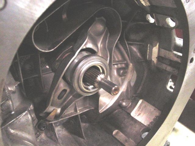

Doug,
I took a slightly different approach to the problem by adding a machined spacer behind the TOB in order to get the travel in the right place relative to the slave's available travel and fork position. I forget exactly what the 012 TOB assembly looks like, but I think it has the TOB and plastic retainer held by a spring clip or (?). The below photo is what I did on my 01E; If you look carefully, you'll see the machined aluminum spacer behind the TOB. Also, since I'm employing a QuarterMaster clutch, notice that the TOB is the spherical face type unlike the Audi.
The slave cylinder on the 012 is a forward bias type that keeps the TOB always in contact with the pressure plate fingers. The advanage is that there's never a need for adjustment, and it keeps the pedal feel very positive (not sloppy as mentioned in an above post).
With regard to axial travel, I suspect a performance clutch manufacturer can supply you with what they call the "set up height" for their specific clutch assembly. That would be the distance from the flywheel surface to the pressure plate fingers when everything is bolted solidly in place. Additional to that, they should also be able to supply you with the axial travel at the fingers (TOB) necessary to disengage the clutch along with the force required. If you are using a stock clutch, then I suspect that information may be a bit more difficult to find.
Andy

Doug,
Andy
That's a pretty clever and trick piece you made there.
and yes any complete aftermarket clutch manufacture will be able to give you those specs for certain as long as it's OEM FW/disk/PP. Hoever I'm sure nearly any company would be able to forward some sort of "reference point" specs at the very least
Adam
I am also looking at using the 012 trans. Thanks for the tip about adding .020" to the TOB travel. There is one thing I still am guessing at. Looking at Doug's drawing above, how much clearance should there be between the clutch fingers and the fully back TOB position shown by the 90.7mm dimension. This clearance would allow for the finger location to change as the clutch plate wears. Another way to put this is what should the clearance/travel be between the point where the TOB contacts the fingers and then pushing the TOB back until the cyl bottoms out?? Im thinking about .1"
Wayne
Hi Wayne,
From what I've measured with the clutch setup I've planned, the TOB (I get it now) can go back further than the fingers in the fully realeased position (I don't have the exact number to hand), so the issue you describe should not be an issue.
What I was more concerned about initially was the reverse, that there would not be enough travel in the TOB to release the clutch when brand new. which now I don't think now is an issue either.
