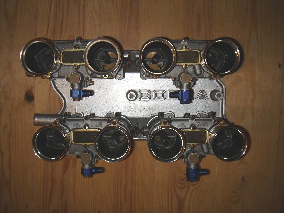

I saw yesterday (at friends garage) 289-302W inlet manifold for 4x Weber IDA. Middle of the manifold is cast outline text "COBRA". Didn`t catch any cast numbers from it, there maybe is. It came from usa few years a go.
It`s at some point modified; from rear there is extra water pipes which are connected to front twin main water outlets. For smoother water temp in heads. Nice bended pipes and good welds anyway.
It´s rare, i know, but is that -right- manifold for modified 302 -engine (in 40)? And, if someone knows, the price level for that?

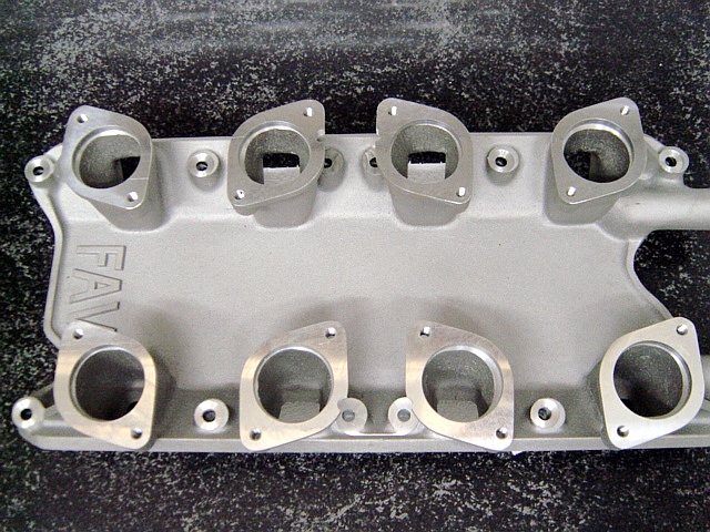

Does it look like this?????
If it dosent have any stamping marks its a repro, I spend a few hours cutting down the letters and the two bosses flat on mine. Original inlets had FAV cast on the top.
Andy
Doc
Cobra -sign is very similar. If my memory serves me well, there is some kind of ribbing in whole area where sign is. Repro then.
I try to put fotos after next weekend.
