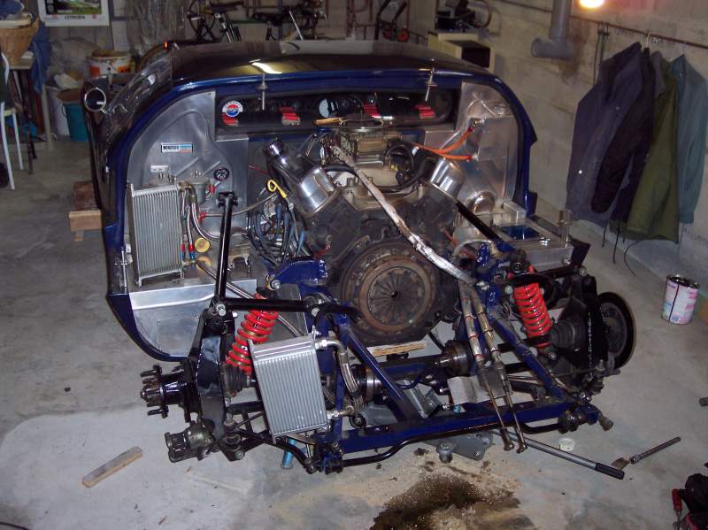

Fred
here the box removed

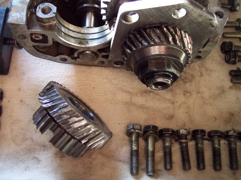

what i found when the box was open, look at the gears, some teeth are missing !!! /ubbthreads/images/graemlins/shocked.gif

Exactly the same happened to me on my first trip to Castle Combe for a track day. It was on the road driving to the circuit when it happened accelerating from a roundabout. As soon as I put it into 5th, BANG. No teeth left on those two gears just like you. That was back in '99.
Chris Cole sorted me out also.
I called Chris this week, sure he's a fair guy ready to help you and has the spare parts on shelves for 200£ (set of 2 gears) if you want to reach the "mystic" 300 Km/h (190 Mph) he also has the set on shelves for 400£.
May be Dave Champ could tell what he think about it, don't you Dave ? /ubbthreads/images/graemlins/wink.gif I know now why i couldn't follow you in Mulsane straight ! /ubbthreads/images/graemlins/grin.gif
