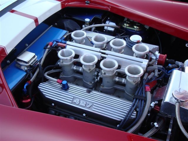

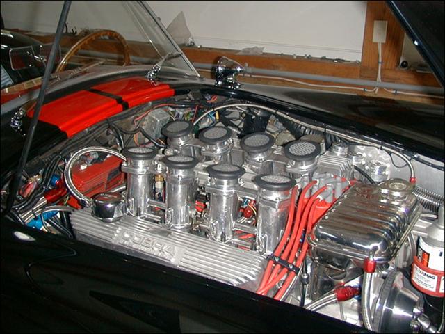

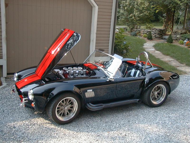

I had a TWM setup on a 496" 427SO Cobra I sold. Great looking and performing!
