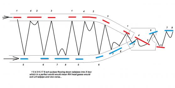

No need to retreat, your correct on just about all points. The X-box needs clarification in that it should direct the flow from the RH bank toward the LH tailpipe and vice versa to function correctly. There are some versions on the market that do not do that and cause a lot of turbulence in the X box in the process. as for the Y pipe to go to a single large tailpipe that is my preference, both from a noise level and power factor.
attached dwg shows how the 'pulses' of exh gas merge within the X box in theory.

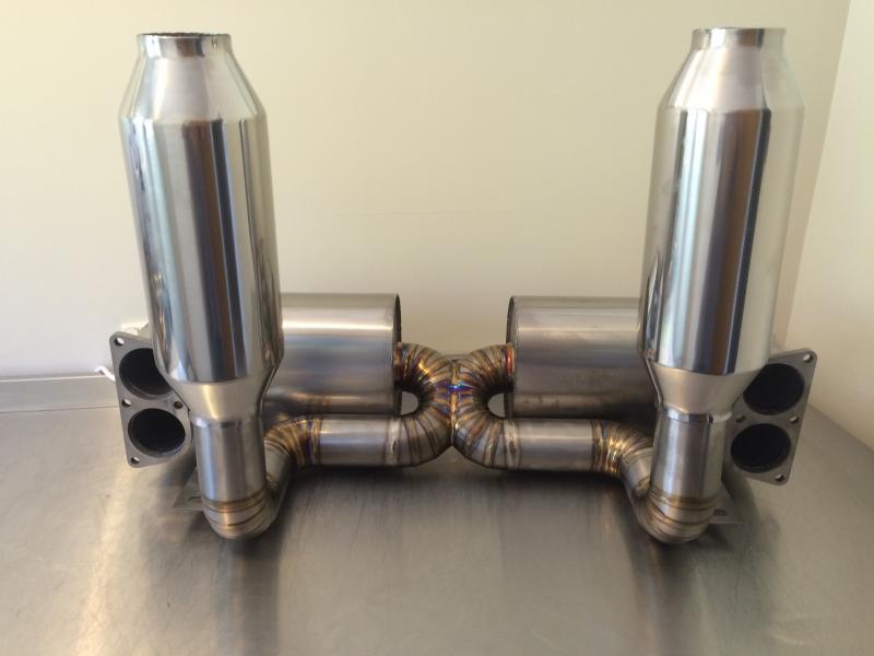

Ok, so I have a flat plane crank in my V8, and was going to just run two straight pipes out the back. Any benefit of joining them with an X pipe like the one in this pic?
I would think only from a noise aspect, but there might be some advantage in the extra length of that layout. That design of Xpipe would lead to quite a lot of turbulence at that point. I assume your headers from each bank are tri-y design going by the double port flange on each side in the pic.

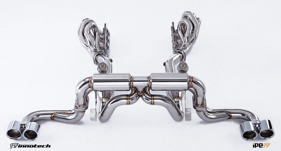

Here is a slightly different system, but with the same arrangement, in full (this set has a bypass valve after the X pipe to alter the sound).
4 into 1 header, cats, X pipe, muffler, twin pipes to outlets
Forget the twin port outlet, it's more about the effect of that X pipe vs. not having it, and running them as completely separate banks from headers to tips.

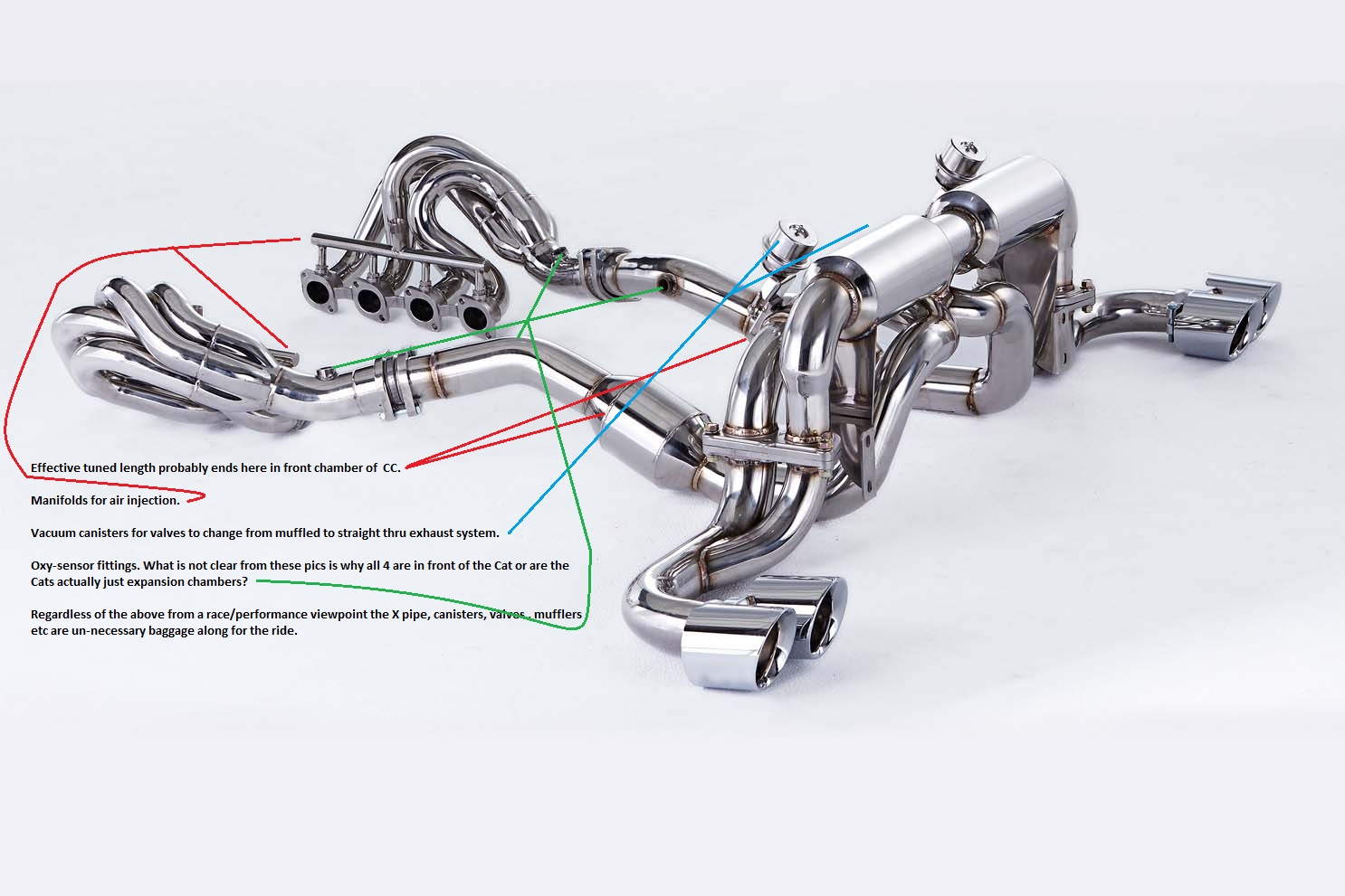

I see no need for the X pipe in that 180° crank race application.For street use it might be reqd for noise purposes. I guess not many Ferrari owners would want to get their hands dirty to remove the mufflers for a track day so the idea of pushing a button on the dash for straight thru exhaust would appeal.
Attached pic with notes from different angle might help. I had quick look at the site & still not sure if those are expansion chambers or Cats with a chamber.Again the Xpipe on a 180° system should not be reqd.
Cheers mate, I could see no reason for it either. Great explanation on the pic too, regarding the effective tuned length. And those air injection rails on the headers are a US-only requirement.

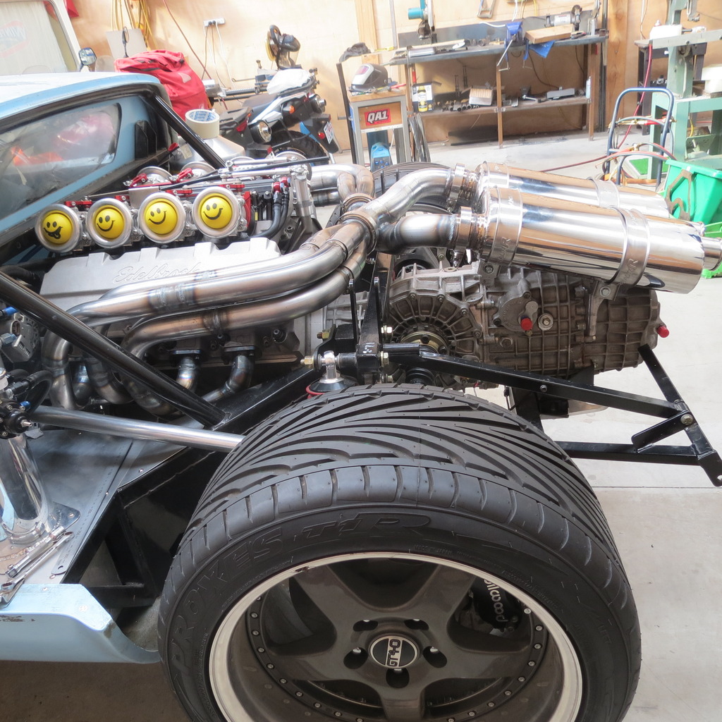

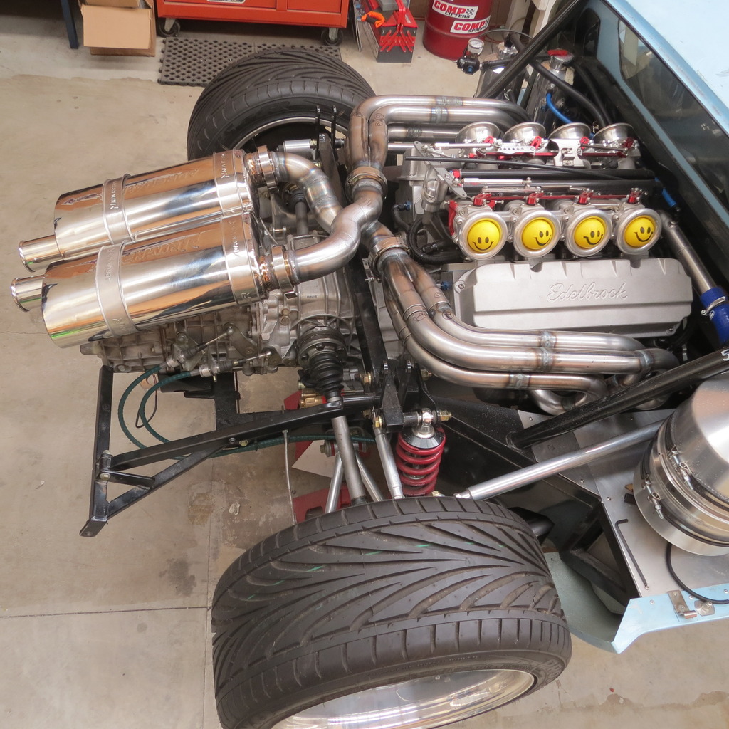

I made 180° headers for my 40 and they ended up too close to the clam shell, even with heat protector the physical size of the engine made everything very tight. So I started again this time keeping the primary length shorter closer to where it should be and the secondary longer.
I made the X pipe in the secondary's only because it sounds better and defiantly quieter.
This new system picked up nearly 20 Hp. I believe the longer secondary is where the power is, being consistent with dyno runs in the past the primary length doesn't make as much difference as the secondary.
It doesn't look original but not a lot of this car does, however it is good fun
