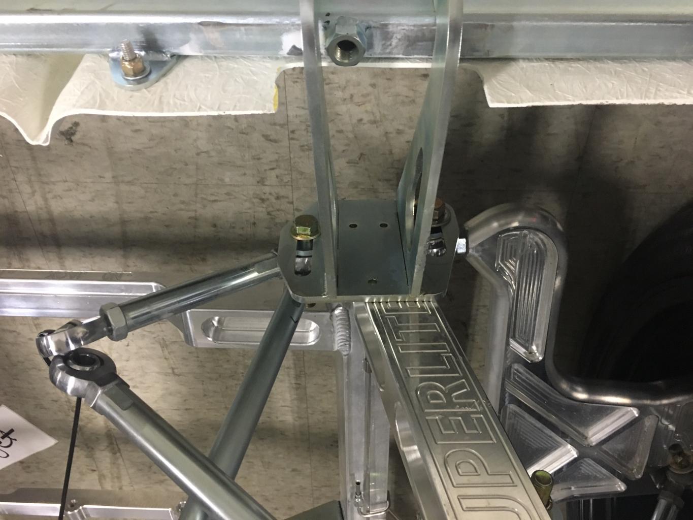

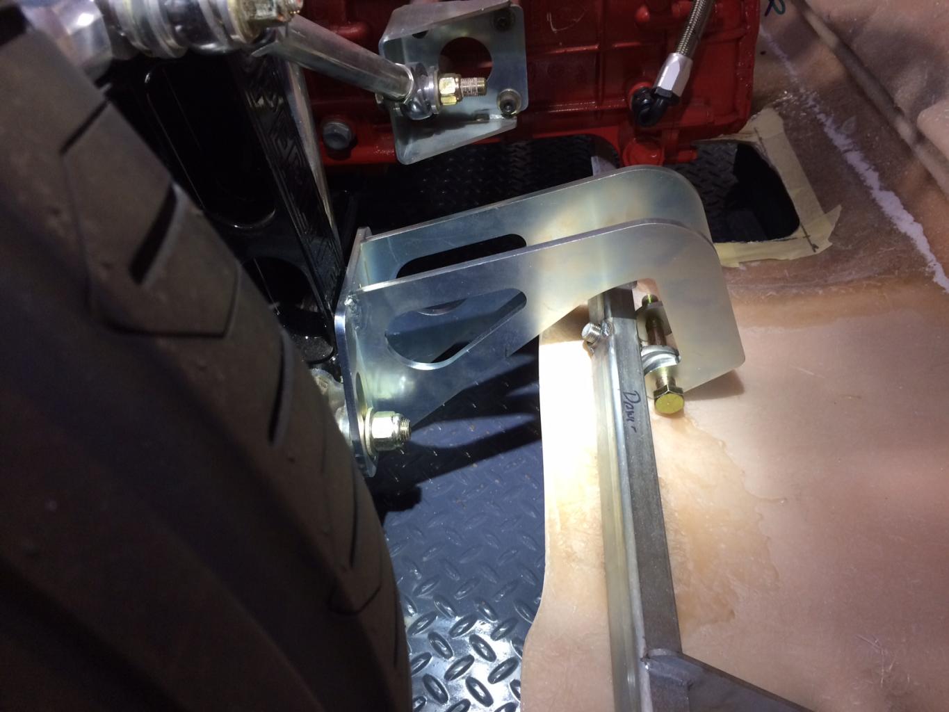

Saw the 90 degree hinges on another blog and ordered a set. They are well constructed, but I am having a problem with the STREET tail that doesn't occur with the original tail mounts.
The tail support bar mounts to the tail in the same location that comes from the factory, but I replaced the welded nuts on the tail support bar with threaded tubes that go all the way thru the square barl. This allowed me to remove the jam nut and allows the weight to disperse across a wider area of the steel tube.
As you can see in the picture the bracket mounts like the old support on the two bolts for the lower A arm and I moved the heim joint to the back of the support bar to fit the new 90 degree fitment.
The problem is the tail no longer moves forward enough to meet the main body as it did before. Its nearly 2 inches short of proper alignment, and there is no more forward adjustment in the heims (screwed all the way in).
I saw no restrictions on the 90 degree hinges limiting them to a race or street tail, so I do not believe that is the issue. I'm not interested in modifying any other brackets to make them work. I assumed they were remove and replace. Can anyone share what is going on. Did I install them as intended? If not how do they go?

PeteB
I had the same problem. It looks like you didn't cut the crossbar. It's hitting the bottom of the transaxle, keeping the clam from going far enough forward. Mine was also too low, even adjusted all the way to the top of the slots. I had to cut the slots to allow the hinges to be adjusted higher.
Pete
Cross bar is cut. I will weld it back well below the Graz once I figure this out.
Height doesn't seem to be the issue, rather fore and aft. Do you have the race or street tail?
PeteB
Looked at your pictures again - I had to cut slots in the clam where the hinges are. They were hitting the fiberglass.

I see the cuts you made. For some reason I don't need them. However I see your heim joint is much further aft than mine. Mine are threaded all the way to the bar and the tail is still too far aft. I need to move forward.
How can the two cars be so different?
Do you have an idea?
It's like the hinge is too long, forcing the tail too far back. Just doesn't make sense yet.
I just can't visualize what the geometry is when it's closed. Seeing it from the inside when it's closed might help see what's causing the fitment issue.

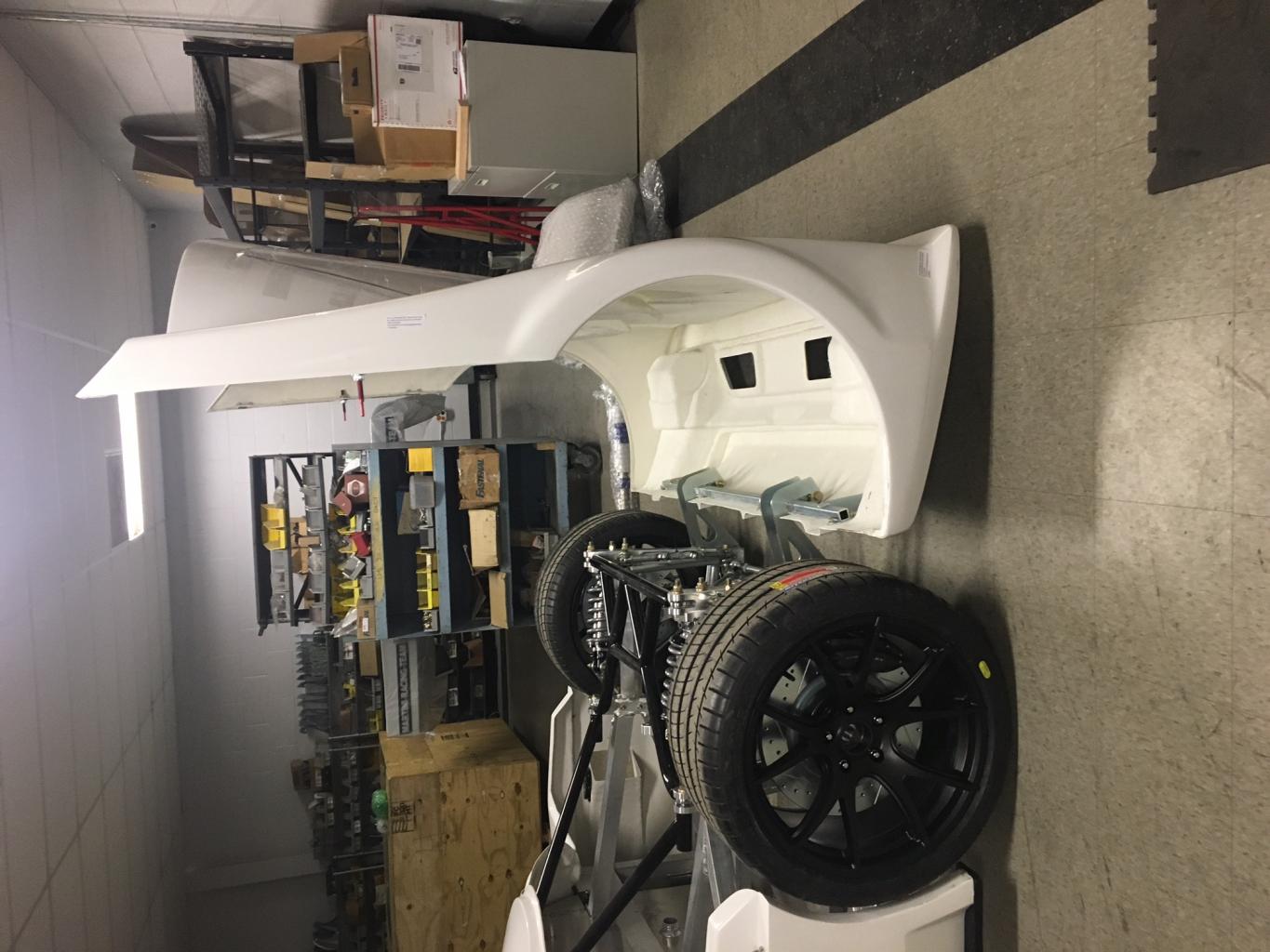

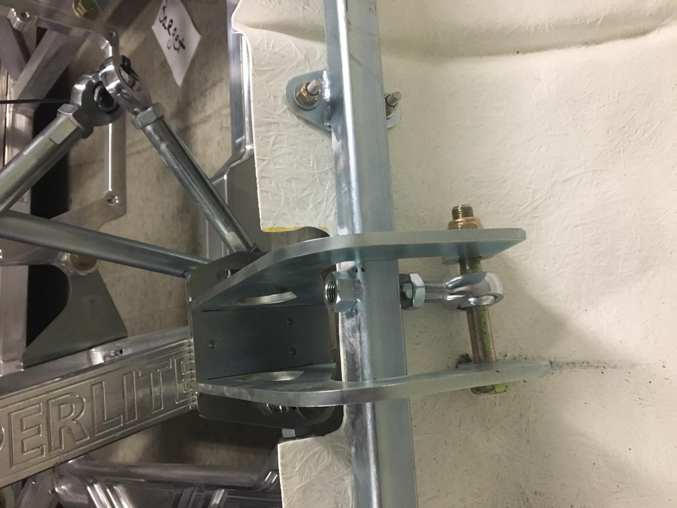

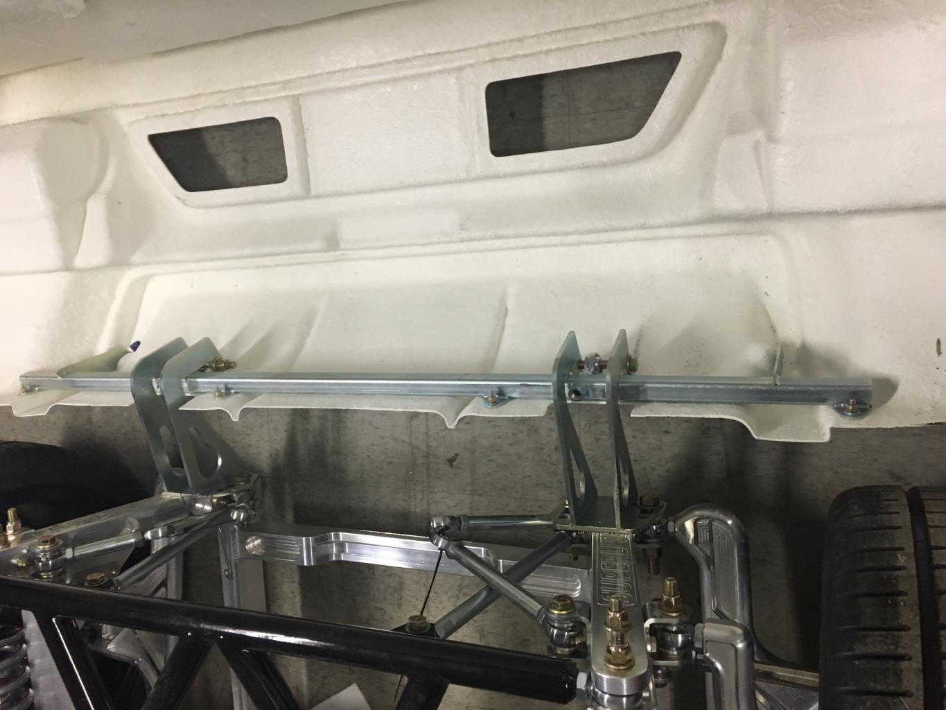

Not sure what your installation issue is
But here is one at the shop right now
I just took these pictures two minutes ago
As you see the tail hinges a full 90 degrees and the hinge itself prevents the rail touching the ground

Thanks Fran.
Between Pete's picture and your third picture the solution hit me right between the eyes. I couldn't see the forest for the trees...LOL.
I was threading the heim joint all the way in which was forcing the tail back instead of forward. The solution was simply to obvious....need to take a break.
I will however beef up the nut on the cross bar........that looks like a lot of force applied to that welded nut. I plan to weld a longer threaded tube in place of that nut to spread the tension out some more.
