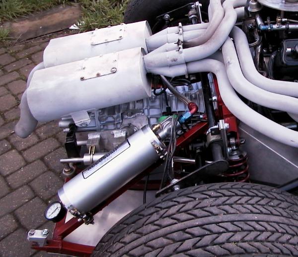

Below is pic as was installed on Roys Mk1 GTD. Worked very well for Pre-oiling - would hold 40psi + on switch on for some 25-30 seconds (engine not running). Worked reasonably well in corners and held pressure when not in use for ages!
One thing to consider is a separate switch to isolate from ignition so the valve only opens when you want to start the engine. Otherwise (for example), you will discharge the unit if you switch the ignition on to check fuel gauges - just a thought.
