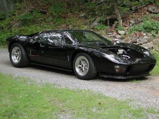

The picture Bill posted of 1076 is one of my favourite GT40 pics. I know it's very subjective, but I just love how the big Al spoiler adds to the visual balance and aggressiveness of the car.
