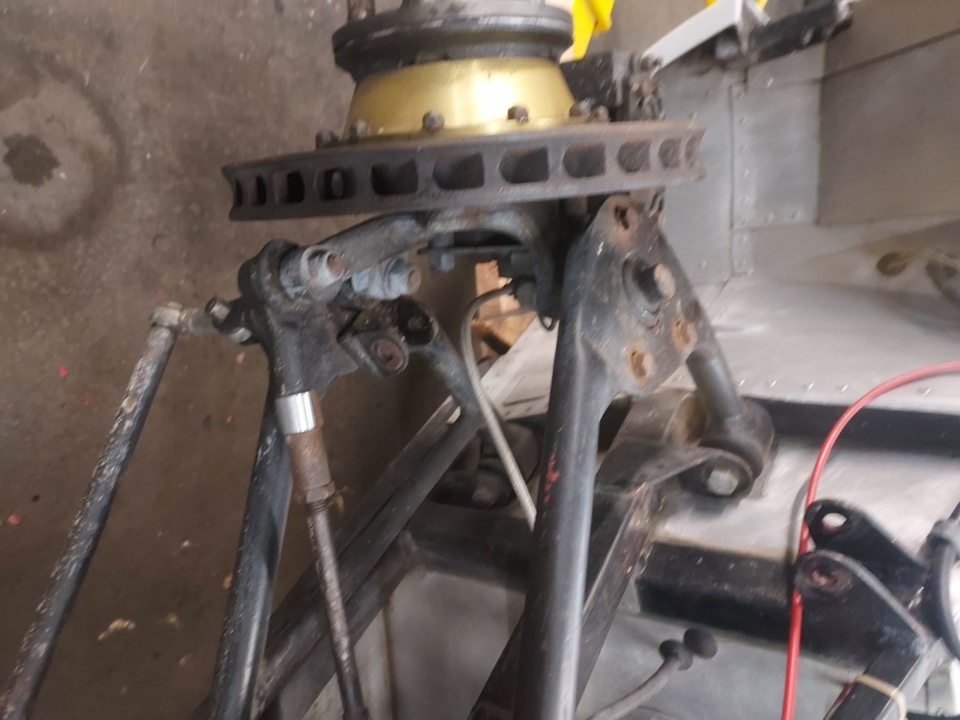

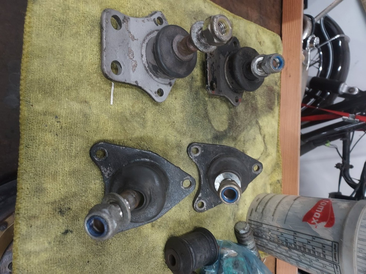

Hello all, find attached a picture of the upper and lower ball joints on my GT. Plus an as installed shot. I'm doing a full tear down of the front end of the car. These are in very good shape, but are of a vintage where the design does not leave them serviceable-no grease Zerk. I've had comments that I should update my front end. I like original, and though I continue to rewrite my cars history, very slowly, I want to stick with what I bought! I've heard they appear to be late 60's to late 70's big American car stuff. But given the car was built in the UK, circa 1980's, possibly a English Ford part. Regardless, appreciate the input.

Think they are from a UK Ford Cortina. The attached link should give you a good starting point for getting replacements.
Think this thread might be of some use to you Brian,
