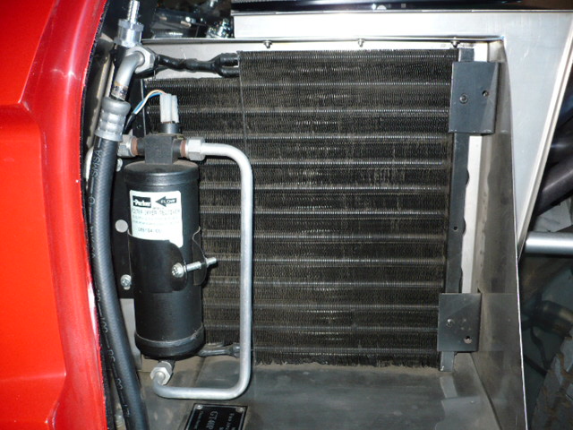

Steve Julius Oct 1, 2019 #2 My CAV GT40 condenser is 13" X 13" X 1 3/4" . Works quite well even in Phoenix. -Steve
