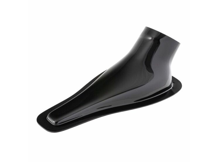

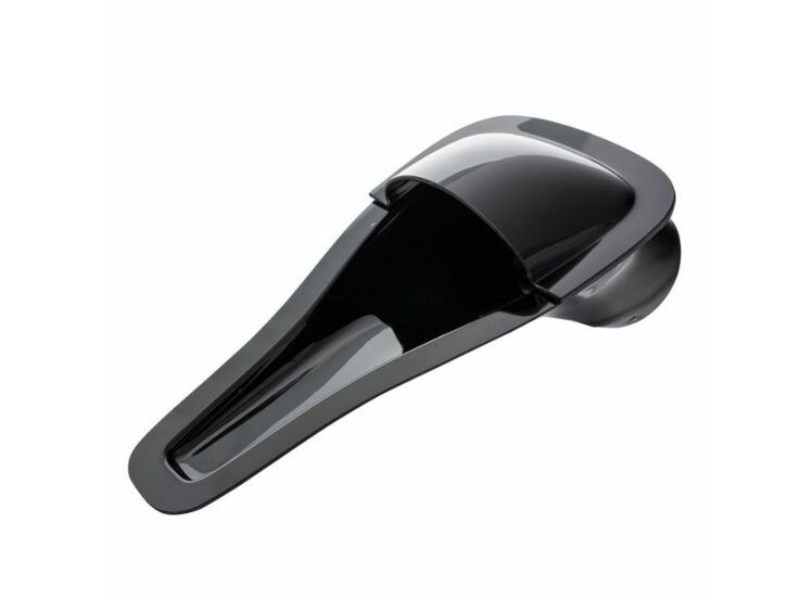

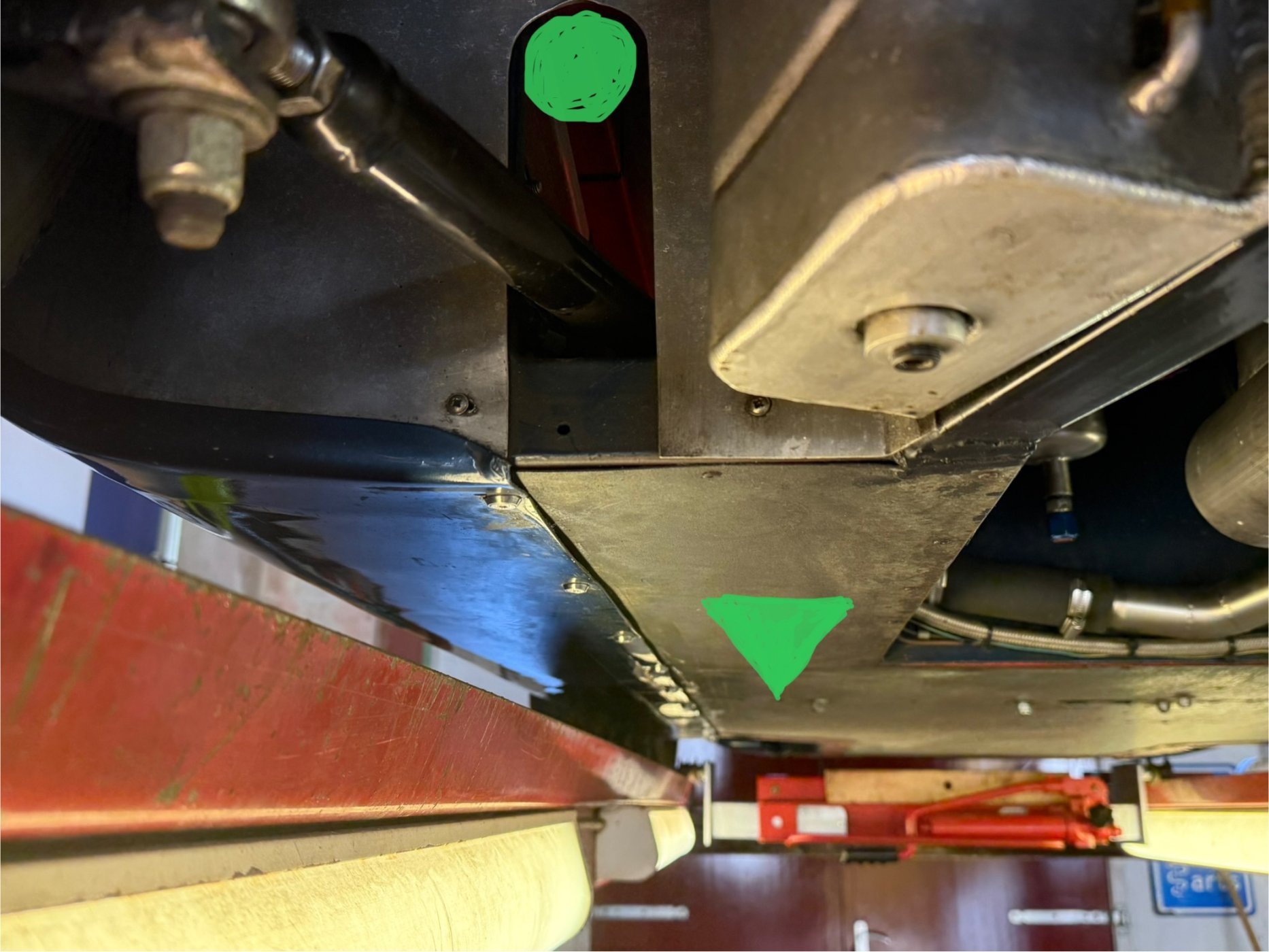

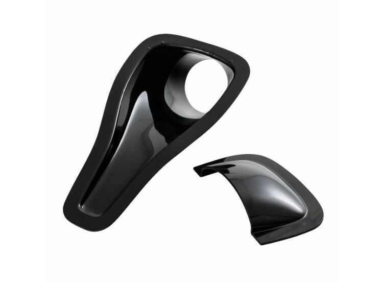

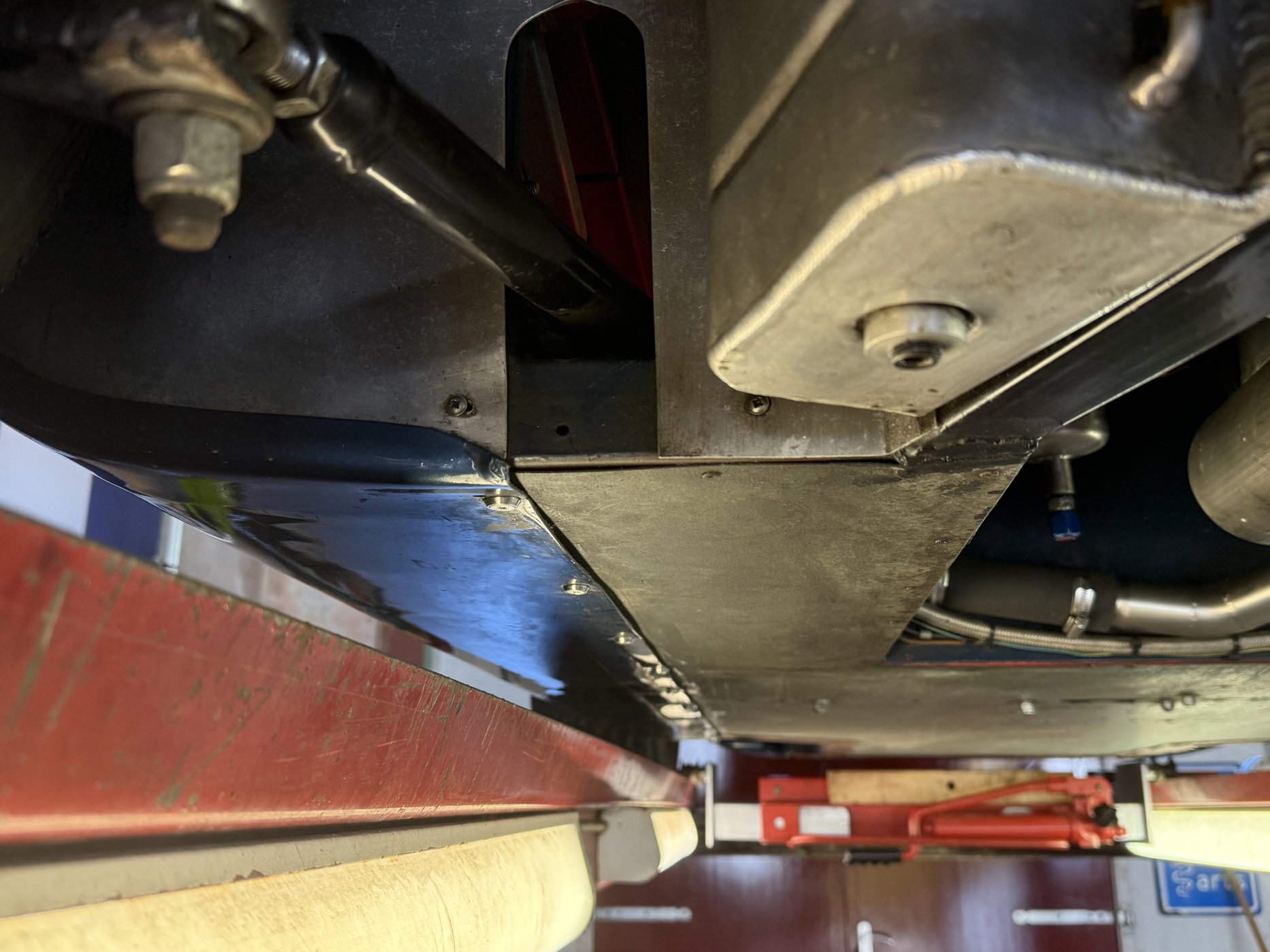

I am thinking of a Naca duct in the floor of the car (with or without an air scoop?) (see 3th photo, green triangle)

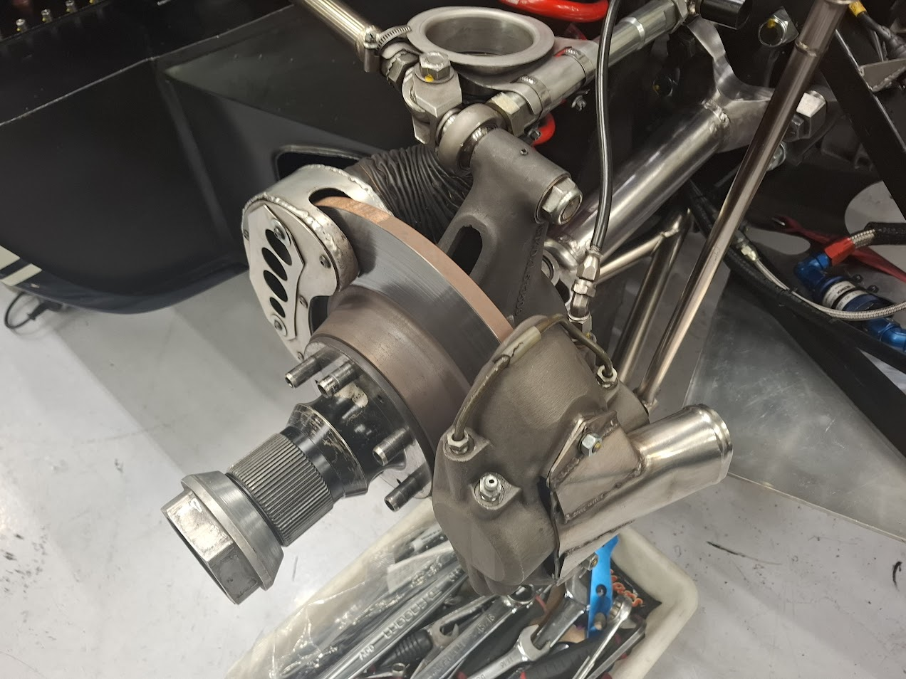

From there a flexible hose to the rear ventilated brake disc, through the recess of the suspension arm, since I don't think it has that much travel. Otherwise next to that. (see 3th photo, green dot)
What do you think?
From my experiance with design and racing gt racing cars, the area under the car is low pressure so will produce no positive air flow thru the duct.
I am of course, open to be corrected.
Jerry
As I was saying, I am no expert, but I believe that there is a lot of airflow underneath the car. That's why in F1 cars the aerodynamic of the floor is at least as important as the rest of the car. The faster the air flow is whats creating the ground effect.

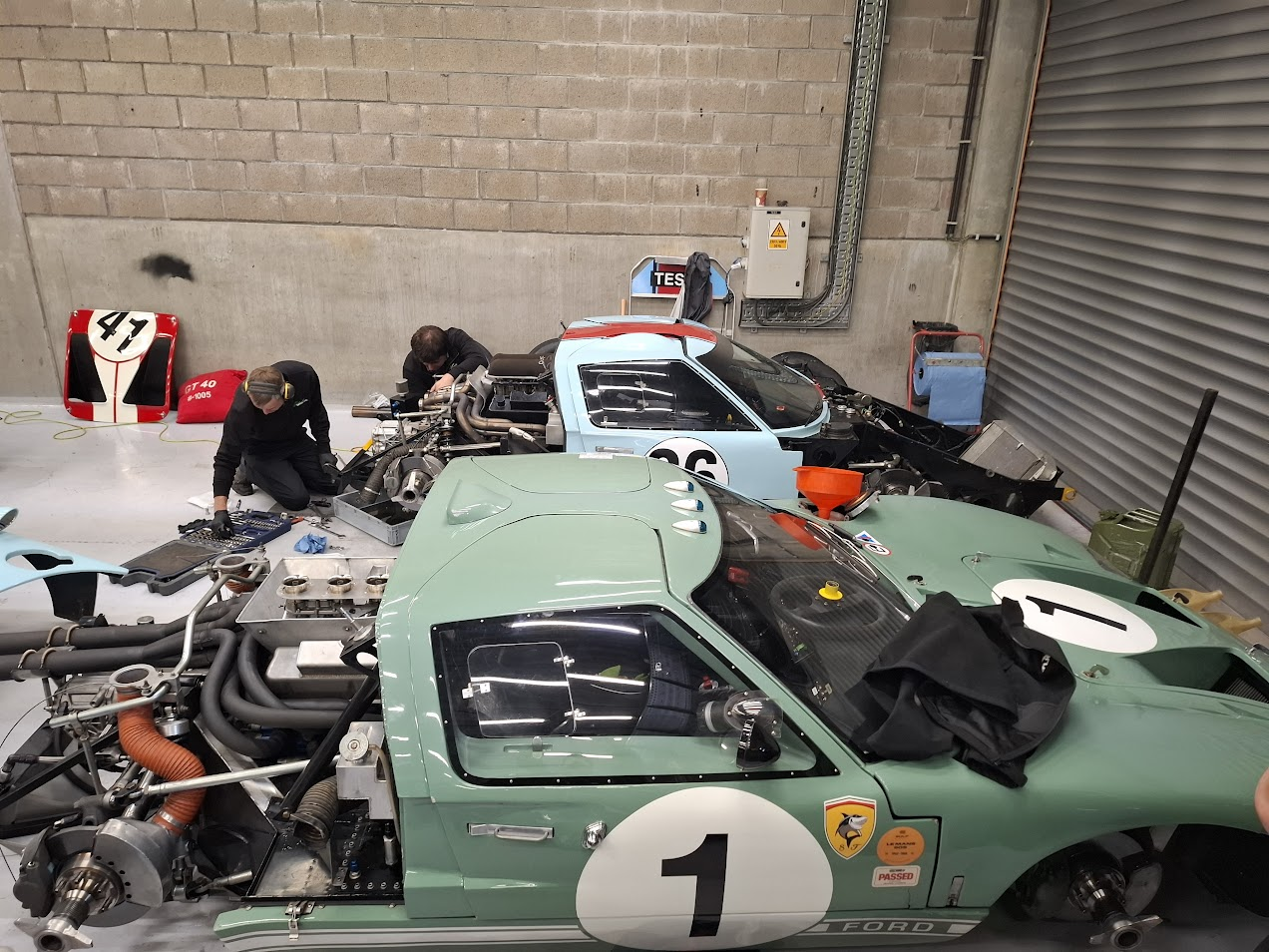

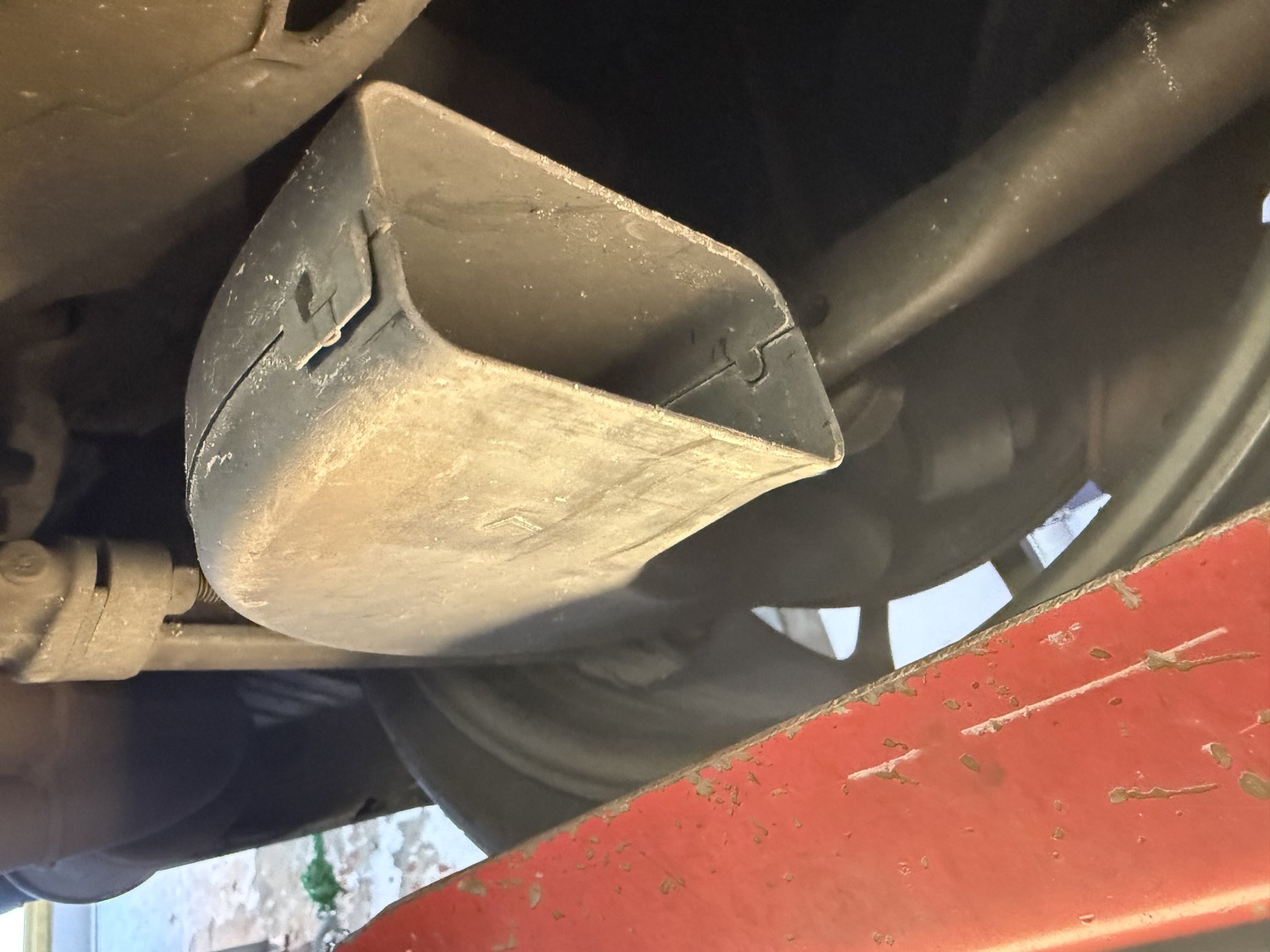

My GT3 also has air scoops onderneath for rear brake cooling:
Davidmgbv8
The original GT40 side scoop provided air not only to the engine compartment, but also dumps out into the rear wheels. Is that not enough cooling?

That’s some pretty exotic brake cooling. On cars with vented rotors, they tend to direct the air into the middle of the rotor. I guess this is the best way for a solid rotor. I like it.

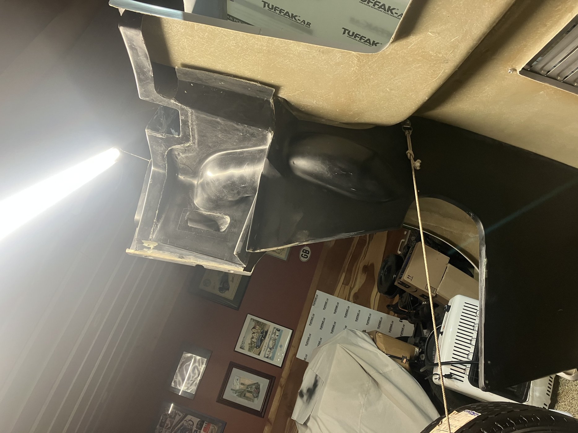

How about the Mk11 top of rear deck scoops. Seen a lot on replica MK1 cars and in my opinion do not look out of place

There's high pressure right in front and to the leading edge beside the tire. And it's conveniently close to the brakes.
With a splitter and disfuser under the car should be low pressure, but it is flowing so the NACA should do something so long as it's not discharging into a very high pressure area.

And I am going to make a duct that goes directly into the heart of the ventilated disc, which is the best way to cool ventilated discs.
