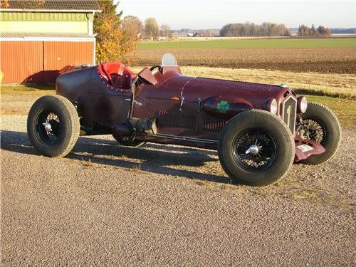

I must have missed something… Wouldn’t the most obvious choice be an Alfa Romeo transaxle? These are used in 75/90/GTV. Such gearbox is used in the replica below.
