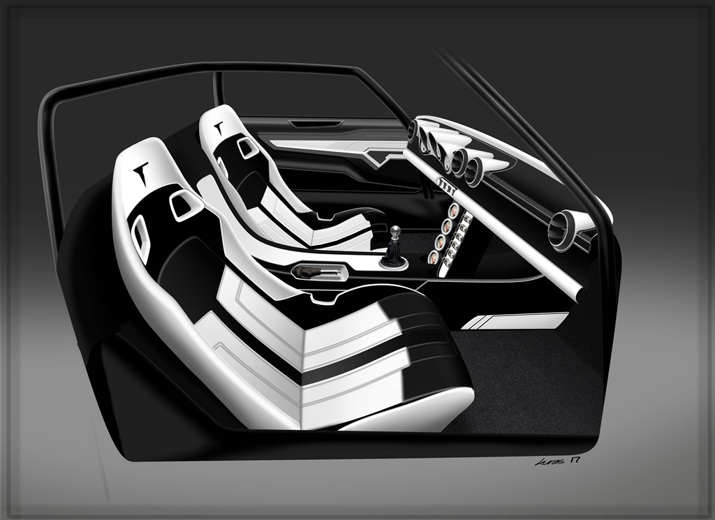

Thank guys, I need to get a sample. I think I am going to use it for the "white" color on the dash, since those would be a PITA to cover.
