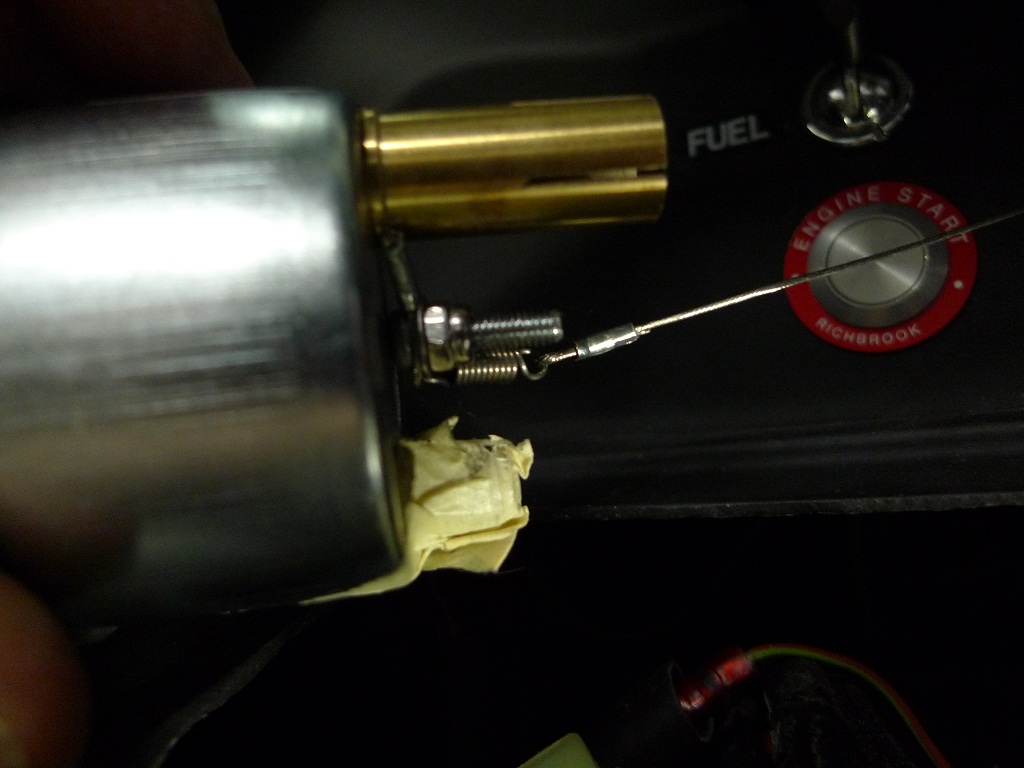

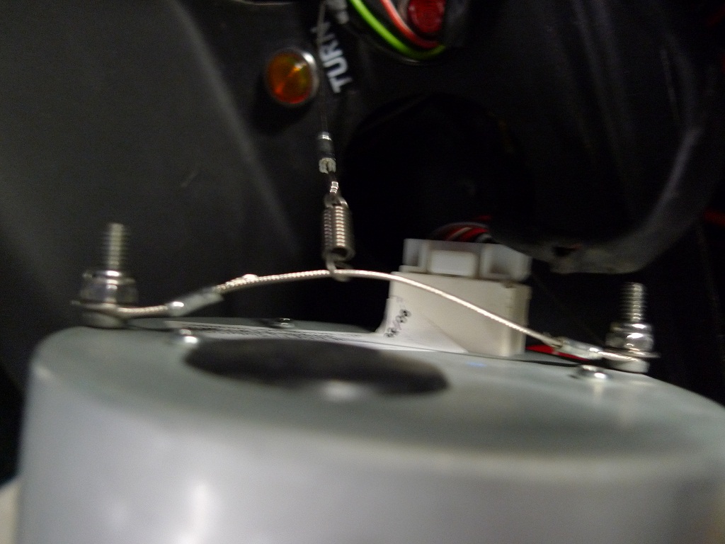

I solved the problem by attaching a relatively stiff coil spring to the rear of each instrument and a steel cable to that, which when fed through a 1/8" hole in the frame behind the instrument can be terminated to the frame under tension.
See pictures below for how each instrument was attached to the cable, and how the cable was attached to the frame. The cable anchor point will be covered by carpet. The materials I used were:
Each instrument can now easily be removed by the detaching the forward end of the cable from the anchoring screw and pulling the instrument out. The cable should be relatively long (eg 12") to provide adequate service loop so the rear of the instrument can be accessed without completely removing the cable. This also makes locating the anchoring screw easy. If the instrument is to be removed completely it is best to detach the cable from the instrument since that is easier to do than re-routing the cable.
I located the anchoring screw first and then formed the forward loop in the cables such that the cables would be mildly tensioned when looped over the screw. The anchoring screw is deliberately shown partially tightened, and the cables are shown prior to removing excess cable beyond the sleeves. The 1/32" cable breaking strength is over 100 lbs.
The 1/8" holes in the frame behind the instrument need to be located close to the instrument's and dash hole's centerline to assure the instrument sits flat in its hole. This means the drill will not be perpendicular to the sheet metal, so center punching is called for.

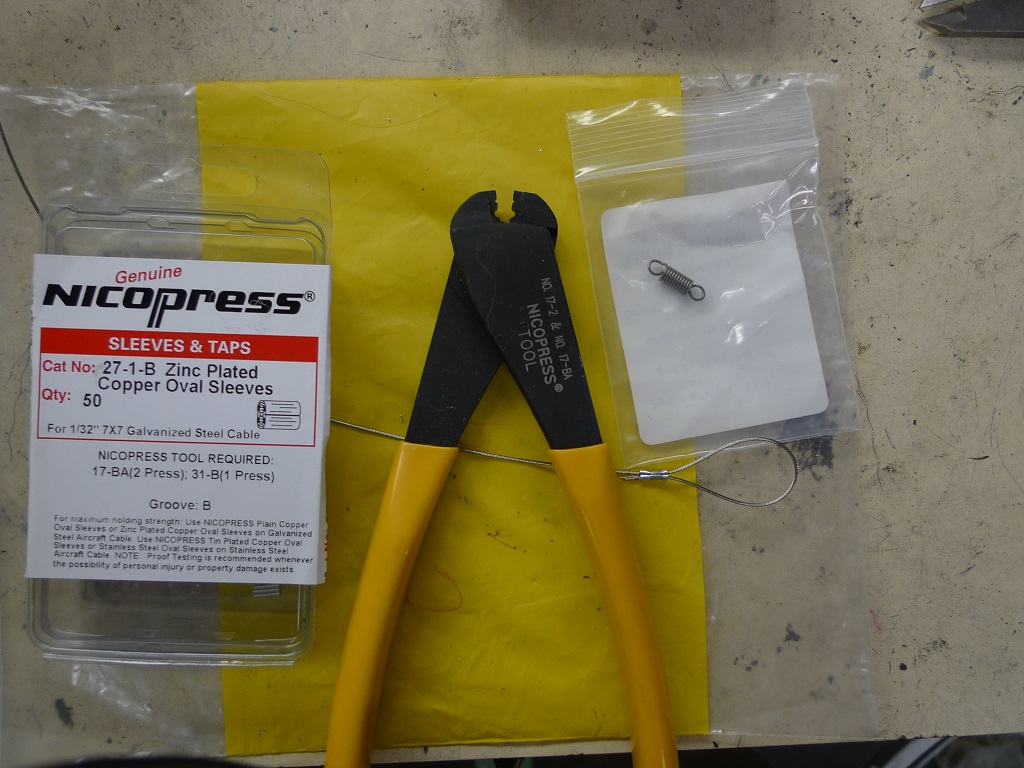

- 1/32" Type 304 Stainless Steel Wire Rope, McMaster 3461T188 $6.50 for 50 feet.
- Zinc-Plated Copper Oval Compression Sleeve for making loops in the cable: Mcmaster 3898T29 $2.12 for 50.
- Single Diameter Compression Tool for crimping above sleeves: Mcmaster 3377T23 $40.73
- Music Wire Ultra-Precision Extension Spring McMaster 9044K53 $8.18 for three.
- M4-0.7 locknuts and washers to fasten wire loops to instrument studs.
