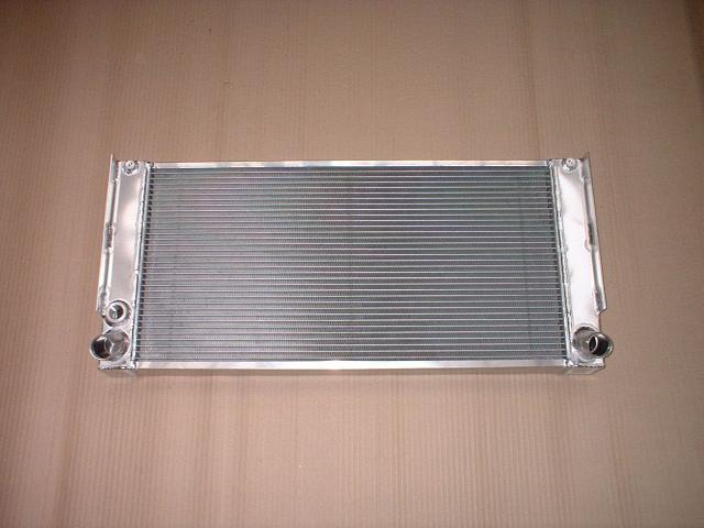

We have them in stock. weight is 9lbs compared to 27lbs plus there is an additional weight saving for carrying less water.
Andy
Malcolm
I swapped out my tired standard GTD brass, weighs half a bloody ton rad for a Docking ali one in 20 minutes, no issues on fitment. Pace and Docking both do good products, Docking is a bit cheaper. The depth of the rad is less with an ali one, at first I thought it may not cool so much but actually it works as good as before (except the ali one doesn't have a million holes in it!) if not a bit better. My thermostat switch also just swapped over without a glitch.
