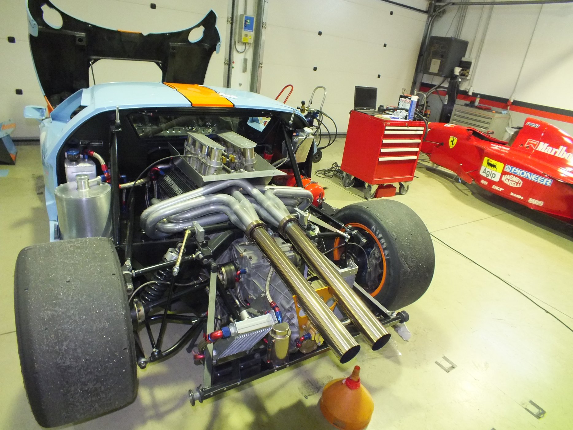

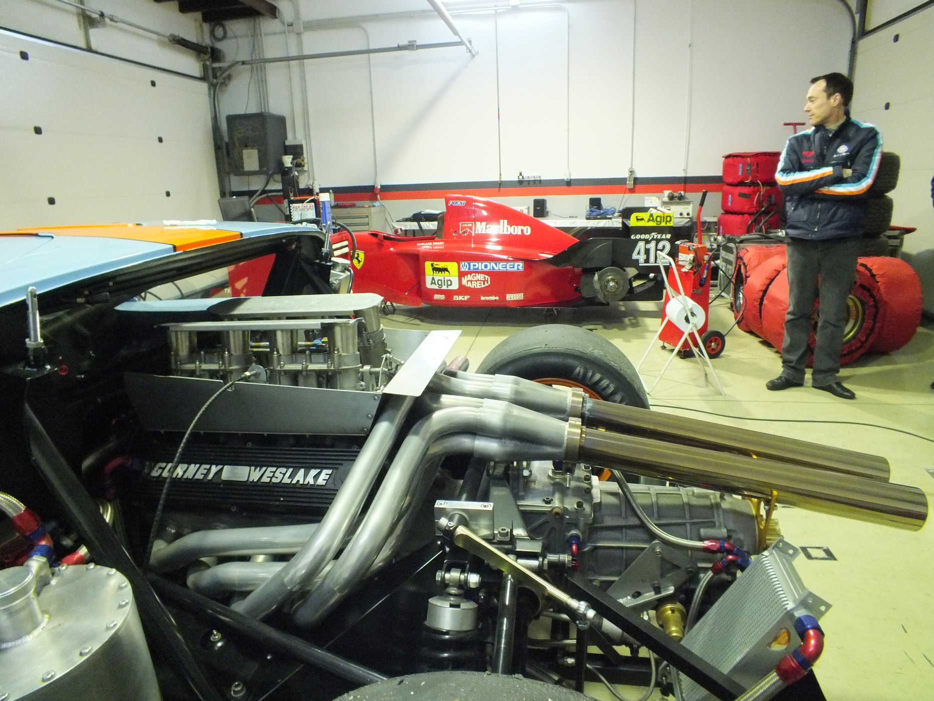

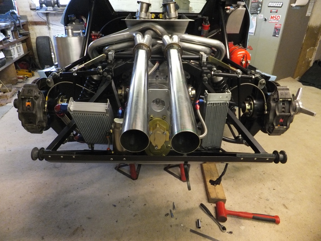

I am just an old amateur, but I use a different way altogether. It depends on whether you are using the bar as a beam to just transfer load across the car, or using the it as a torsion bar that twists with load to act as form of a cross car spring, these then controlled by rotational beams to allow stiffness settings individually each side of the suspension. (Based on led as used by Fords competition cars , rallying etc.) I find that this works very very well on the 40s. See picture to hopefully explain my poor descriptive effort!

Your descriptive effort Frank makes perfect sense.
If the car was going to be a track only (and smooth track at that) car then the bar would doubtless be designed for load transfer across the axle - and no doubt be of a battle ship design! This I believe is the likely "worst case" scenario for loads through the drop links.
The bar in question is a 3/4" solid item and more likely to act as a torsion bar I think to retain a greater amount of independent control at each wheel.
