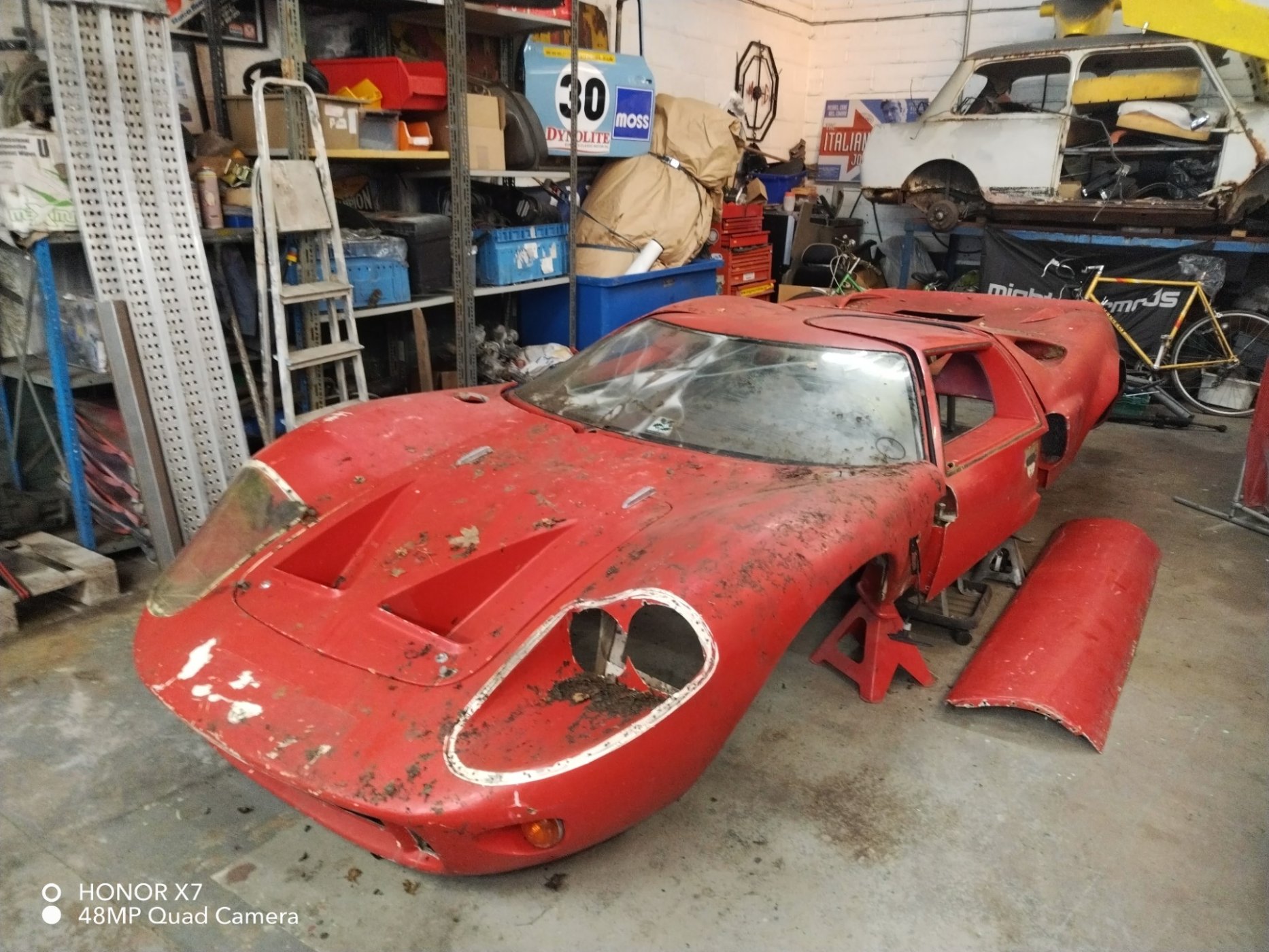

Hi everyone, My name is Luke and I bought a couple of years ago a MK3 KVA from a hedge in Barry island in south Wales. The car has a known history and was bought by a fellow GT40 club member stripped and this body was sold/discarded in the process whilst he retained the chassis running gear. Luckily for me I have access and secured a 1984 KVA chassis that is brand new so looking to build a new car from it retaining the MK3 body. Initially I would of loved a mk2 ideally but the MK3 is different and I've grown to really like it as i have researched more and the fact you rarely see them. there are some amazing builds on here and are incredibly inspiring.
Im a bodywork guy and a reasonable fabricator so looking to do most of the work myself and learn as much as i can. i never thought i would ever have the opotunity to own a gt40 rep so i am currently selling other cars and assets to fund the build.
initial plan is
302 motor that I already have all be it in bits
Audi transaxle again I have acquired
Retain the KVA suspension on the front the rear end will need to be lengthened for the MK3 body so might go to southern GT and get them to modify it and update the rear suspension
I still go loads to learn and figure out but assembling parts over time. my best mate has a MK1 gt40 so its cool we are building both cars in tandem all be it in different directions.
I look forward to researching and speaking to you guys. the body is in really rough shape so I have plenty of work ahead of me.

Hi everyone thank you for the messages. Thanks Mike will get some pictures when I'm next with it hopefully next week any help would be appreciated.
Hi Steve, so the logbook and body went on another car so will be essentially a new build although I would love to try and avoid a Q plate if possible just have to do some more homework. I've build and been involved with a few different kit cars over the years but need to look into this in more detail. Appreciate any help/advice
Chris , any help with those arms would be a fantastic help

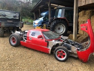

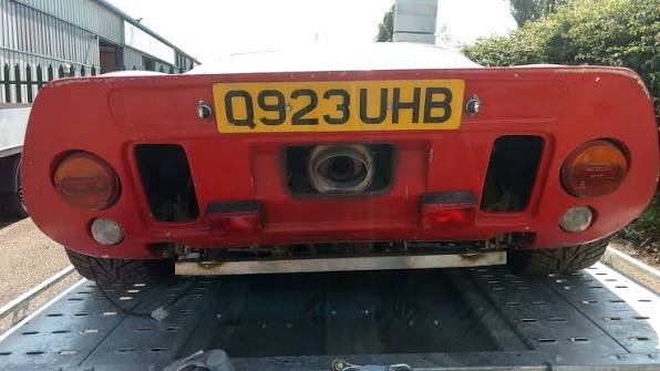

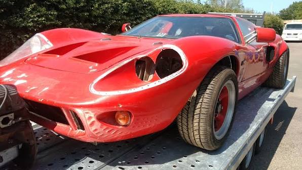

Hers some pictures of the car prior to it being striped. The chassis I have acquired is brand new never been built but is currently at my best mates as he's using it to take measurements for his build ( he's making his own chassis)
