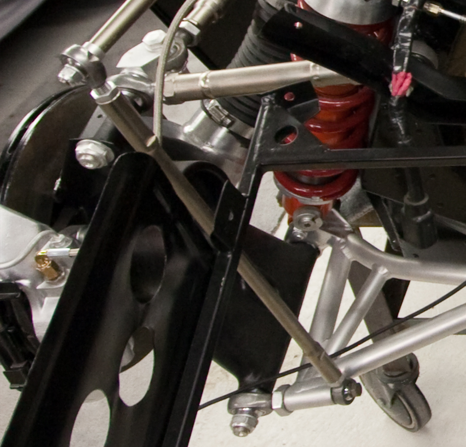

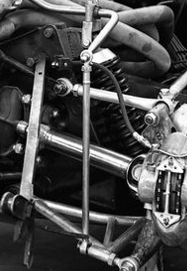

MKII bars are heavier than GT-40' s and have a tapper at the ends and are not adjustable as the one shown, I am afraid I don't remember their exact size, but I believe 3/4 " diameter tapering to 1/2", metric did not exist at this time. I am sure someone has plans out there showing the sizes to be sure.
