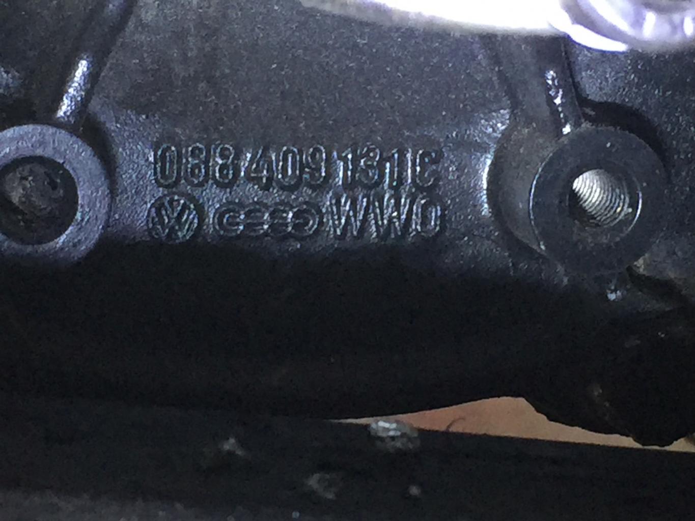

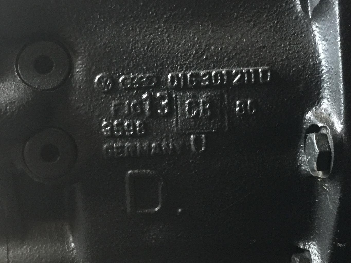

Hi all I'm trying to get a better idea about my gearbox, ie year and car it might have come out of I have the serial numbers attached> Any help appreciated

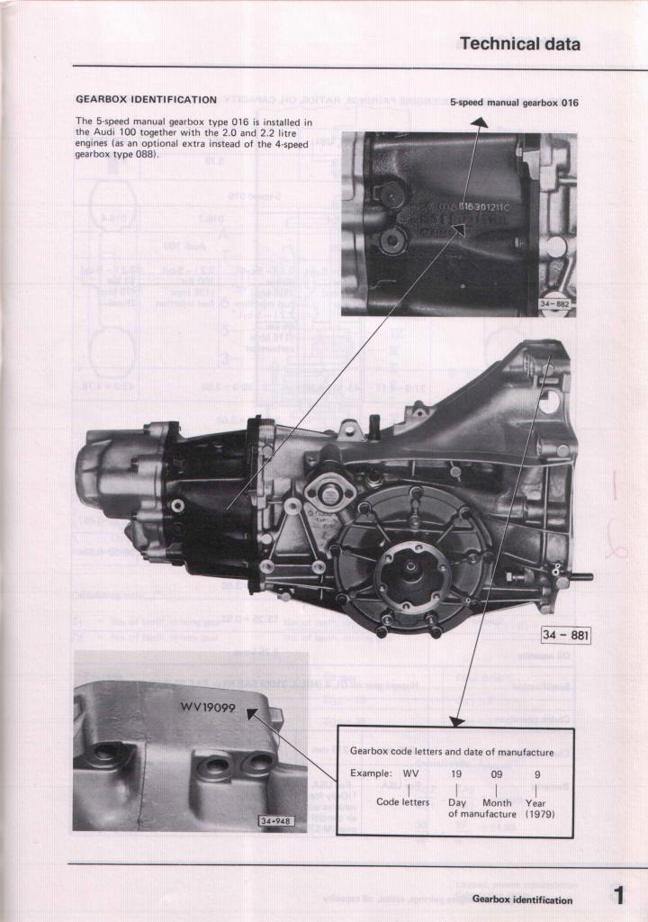

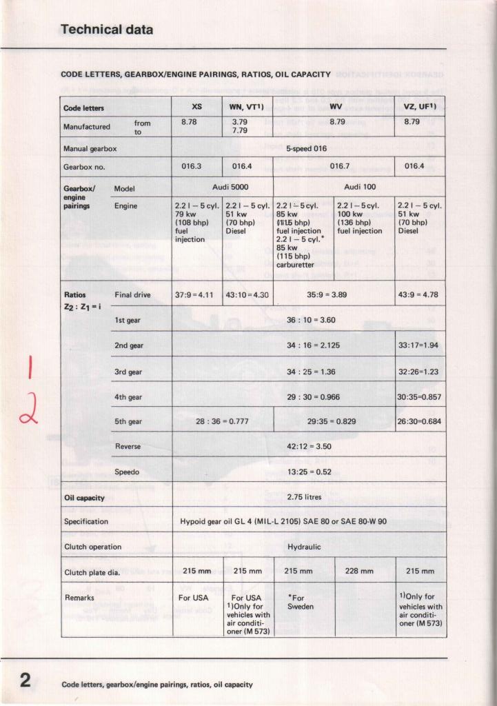

Pat Supporter Oct 16, 2016 #2 You also need to look at the top of the box for the numbers. Attachments Audi100_GboxManual007.jpg 96.4 KB · Views: 1,897 Audi100_GboxManual008.jpg 104.9 KB · Views: 818

Thanks veek So if I read correctly it's out of an Audi 5000 1978 onwards as my code is 016 301 200. I'll double check the top of the box tonight. Cheers
Clayton Oct 17, 2016 #5 Hi Patto As Veek said, the numbers on top of the bell housing are key. They will give you year of manufacture and gear ratios. Clayton
