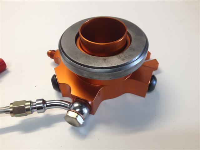

We've created this hydraulic clutch slave bearing with universal fitment features-- and its a great little performer.
:idea:So, we thought we might adapt it to the 01E - 012 trans so that multi plate clutches could be utilised thereby giving a much greater clamp force as required when using the big V8s of Ford / Chev etc.
We'd be greatful for some thoughts or feed back

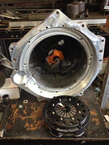

You are probably already aware. But the multidisc clutches have a need for the bell housing to be very closely aligned with the crankshaft. You may want to make it so it can be aligned and then doweled in proper position. I think it is a great idea

Dave, our adapters are dowelled to the engine and gearbox to ensure perfect alignment -- OEM coordinates.

The QuareterMaster pressure plate will require a spherical faced throw out bearing. The one in your photo is flat faced.
Last I looked, the input shaft spline is not quite long enough to completely engage the QuaterMaster and Tilton dual disc setup, though people employ them anyway.
For my 01e, I am using the QuarterMaster 8 1/4" rallye (bronze/ceramic) single disc with white pressure plate spring, and it seems quite adequate.
In you photo, did you have to modify the trans to get the hydraulic throw out bearing to fit?
Is that a Chevy adapter in your photo? What starter do you use for that application?

Andys - Chev LS adapter , using normal LS flex plate and starter (same goes for Ford and Lexus adaptions)
The input shaft extension tube is a custom replacement.
For multi disc clutches, an input shaft spline extension / adapter will be used
