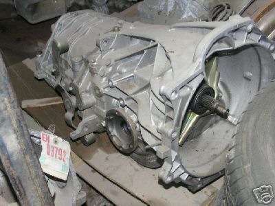

The only real difference in the 6 speed Boxster, is that weird one o'clock starter position. If your adapter plate uses the four o'clock Boxster 5 speed (012) starter position and pocket, then they would not interchange, AFAIK. It mostly depends on how the adapter plate is configured; it is possible though.
Right, Audi 01E (same pattern as 012). Left, Boxster 6 speed
Andy

you're right, I did forget about that too :) One of the missing bolt/dowel provisions I mentioned is actually up by the 6 speed starter.
Neat trick about the 6 speed is the bellhousing can be machined/welded to put the starter over the gearbox instead of the engine. Requires a reverse rotating starter though. I have a few pictures of someone who did this on another kit car or sand rail. I'll dig them up here.

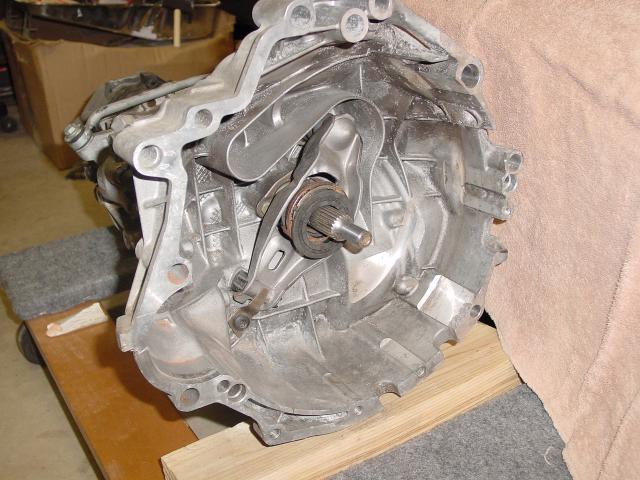

Adam,
Do you happen to know the diameter/spline count of the 6 speed Boxster input shaft?
Thanks,
Andy
Off the top of my head no, but I have the guts of a blown one kicking around the shop somewhere. I'll try to remember to take a look for it on Monday and get that info for you.

I think these might be the input shaft dims being looked for?
