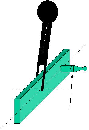

There are a few things that you can do to increase the stroke on the left right of the shifter box, but first you need to make sure you really have it adjusted correctly. I thought I was not getting enough stroke but what I found was that there was a bolt on the part attached to the sector shaft on the transaxle that was striking the transmission case and preventing the sector shaft from engaging 5th and reverse. I trimmed that bolt and solved the problem.
To increase the stroke if it really is the problem there are a few things that you need to do. The first is to look to see what is limiting the stroke. There are a number of heim joints in the shifter box that can strike different objects in the box. A little grinding in the right spots could clear up that interference. Another thing that can be done is to add some washers under one of the ball studs for one of the heims to give more stroke. If you look at the shifter handle, it is hinged at the base to allow fore and aft motion. That hinge is attached to a piece of flat brass bar that pivots to allow the shifter to move left and right. There is a brass rod welded to the brass bar with a ball stud on the end. Put a few washers under that ball stud to allow more motion. This will not accomplish anything if the heims are what is binding.
I actually had the weld attaching the brass rod and brass bar together fail on mine so I had to rebuild that part of my box. This is all hard to visualize but I do not have any good pictures of the shifter.
Below is a crude sketch of the shifter. Add washers where the arrow is pointing. The hiems that attached to that ball stud are the ones that you may need to clearance to prevent them from fouling on things in the box.

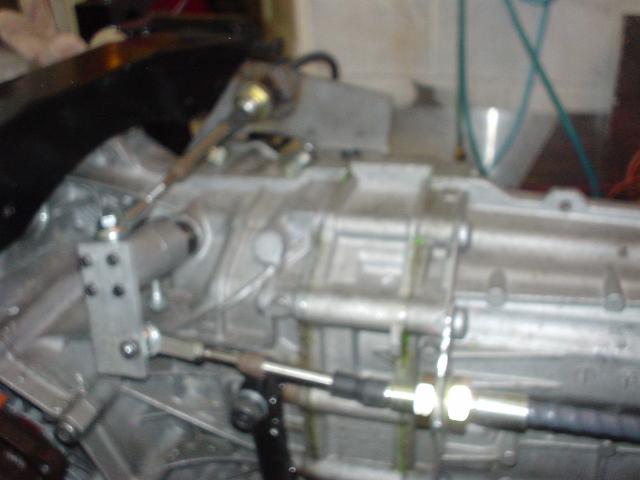

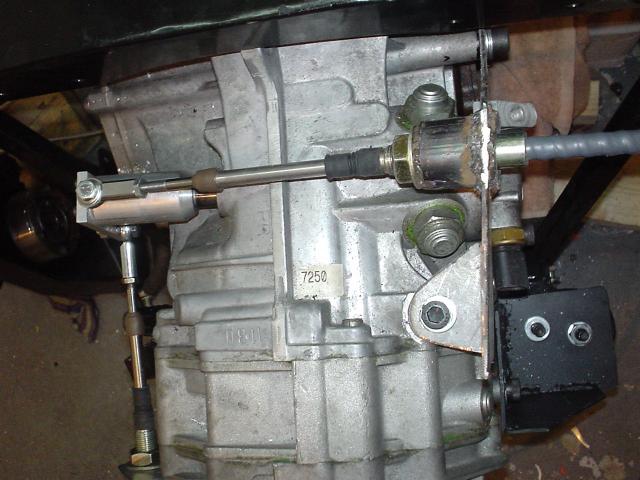

All,
Thank you for assiatnce in the thread and privately. As we all know sometimes one thing during the build can get us all down and irrationality cuts in and you can't seem to see a way through.
Needless to say I am getting there. Having had to make a new bracket to suit the 01X, and I also think I may need to flip the fore/aft control arm; but the main thing is I can get all the 6 gears and reverse engaging. What a great BDay present for Monday - YIPPEE!
Brett
