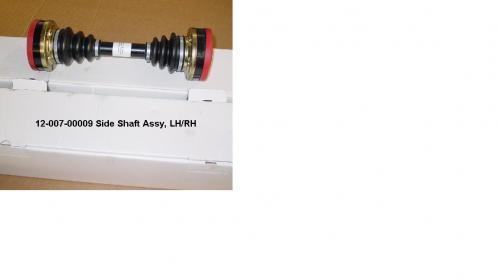

Could you spell out the exercise of dismantling the CV's or could you point to a Youtube video that outlines what you did. I have the 930s from the Driveshaft shop. If yours is different, anyone have the info. Have reviewed a lot of them and have an idea. Just looking for conformation. Where did you get the new boots and bands??
Pic of my half shafts attached.
I did not actually dismantle the CV's. I pulled the half shafts (one side at a time) from the car by removing the bolts from the inside of the half shaft first (came off pretty easily from the gear box), and then the bolts from the outside of the half shaft attached to the wheel (had the break the outsides loose as described above).
Once removed, I cut the old boots off, repacked the CV 'joints' with grease, and installed new CV boots using the 'Dorman 614-001 HELP! Universal Fit CV Boot Kit', and using the 'Dorman 614-030 HELP! Universal Fit CV Boot Air Tool' to get the boots over the CV 'joints'. It was a very fight fit but with a little pounding was able to get new boot over the CV 'joints'. I packed the boots with grease once on the half shafts. I tried using the steel bands provided with the kit, but couldn't get them as tight as I wanted them so ended up using zip ties and they've worked perfectly.

Mark,
Thank you for the information. One last question. You mentioned using sealant on the ends of the shafts. What was the sealant and why did you use it?? When I got the axels from The Driveshaft Shop there was no sealant or mention of it. I have just removed my half shafts from the car, in preparations of repacking the joints and replacing two boots that are "leaking". By that I mean they are spraying grease all over the place from around the large end at the flange. I have the 930 trans, and purchased the axels during my build. I don't know if over the years(11 year build) if it dried out the boots or what but I only have ~2000 miles on the car. I plan to take the joints apart, clean them, and repack the joints. I have ordered the 2 new boots and a tube of Red Line grease(very sticky stuff). I will document the process so that all can learn from it. All the parts should be here by Monday. Removing the shafts was a bit of work but not terrible. The bolts were torqued at 30 ft. lbs. of torque with blue thread locker(which over time multiplies the torque required to get them loose). The force required is aided by adding heat from a map gas torch for a minute or two to the thread ends of the bolt/shaft end before applying pressure to break the bolts loose. These were then cleaned with a wire wheel to get the residue of the locker from the threads. More to follow next week.
Sealed the edges around the 'CV joint' to the wheels and the gear box to keep crud out of the ends of the half shafts since they weren't sealed. I also put extra grease in the open areas between the wheels/gearbox and the ends of the half shafts.
