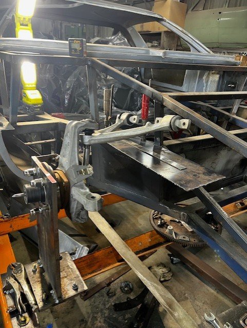

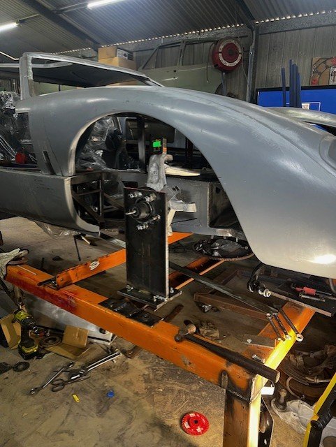

Hi Lance,
Is this for a scratch build or do you have a chassis already?
Full disclosure, I am not an expert on this but have been pondering things of this nature. From what I've gathered, the classic answer would be to start with the lower ball joint leveled up with its inboard pivots. Have you tried that? What does that look like for you? Note that the arm itself may not appear level due to its geometry, it's only the pivot locations which matter. If the pivots and the ball joint are even, the kinematics don't care about the shape of the arm. A slight droop (inboard pivots higher than the ball joint) might have some camber gain benefits for you. There are many other things to consider as well- roll center, instant center, etc... which will all serve to adjust the hardpoints.
If you have a chassis already, with the lower set level(-ish), that would dictate the angle of the upper for you based on where the mounts are fabbed to the chassis.
If you're building from scratch, you'll likely want the upper ball joint slightly higher than its inboard pivots. How much is slightly? Many things to consider.
