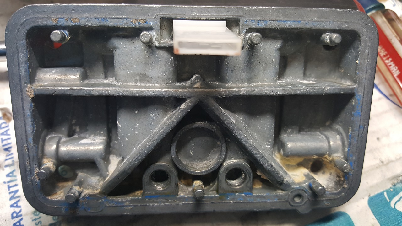

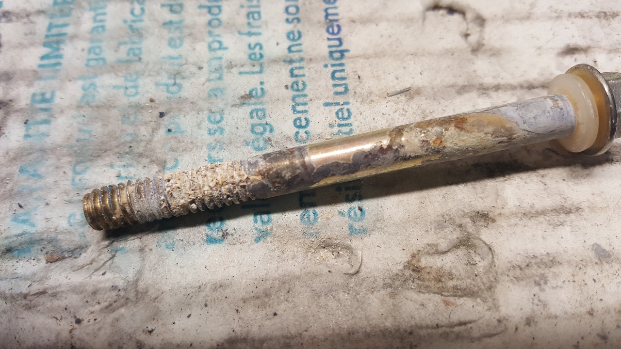

Any carb experts want to analyze what I found in my Holley 4150? It was running really rough off idle, around 1500-2500, with some surging if you tried to hold steady speed in 2nd or 3rd gear. This is the vacuum secondary side.
This stuff looked like battery corrosion - very flaky, crusty. I had to scrape it out with a screwdriver and a pick. After the rebuild, smooth as can be.
See pics.

Ethanol blended fuel. See this a lot in Europe with just 5% ethanol blended fuels.
Ethanol corodes alloy.
Ethanol atracts water... water corodes alloy.
Doing a lot of carb rebuilds for Classic Fords in Holland. Mostly Weber and Solex and your picture is pretty common for me.
To prevent this in the future an ethanol killer fuel is advised. I have good results with Frost Ethomix but Ill guess something similar is available in the States.
The white powder is zinc oxide. Most pump gas is now at least 10% ethanol. Water in the ethanol separates out and causes the corrosion. Maybe gas sitting for longer periods in the carb are a factor? Perhaps an additive for the ethanol would help?
