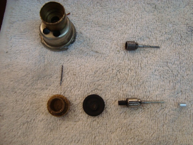

Well... decided to take the SW240 fuel pump switch apart, near all the way. So to make a long story short, appears the round diaphram seal inside the lever cavity gets hard overtime and restricts the movement of the pin arm that opens and closes the points. I replaced this diaphragm and the switch opens and closes the points perfectly. It is a real tedious operation; removing the cripped case to release the pivot housing unit, then removing the .040" pivot wire hinge and machining off the pressed on diaphram retaining bushing from the point operating arm. The finger that sits in and moves with the piston groove has a small spring encapulated in its housing and rocks independently of the points operating arm. This part of the unit is roll crimped in place. Removing this spring and finger would be a major job, however with the six switches done so far this part of the unit seems pretty robust, none have shown any sign of wear. Reassembly is again tedious, pressing on a new diaphragm and bushing then recrimping the unit back into the switch housing. I got all the switches to operate and the test pump I use really pumps. Thought some might find this interesting, I sure did.
