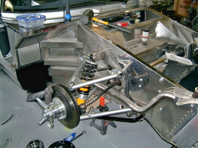

Unfortunately I don't have a picture but getting to the sill interior is a easy process. Once the car is chocked, jacked and the front wheel off, remove the upper access plate behind the wheel and then unscrew the self tapping screws that hold on the exterior sill cover. Once that's off you'll see the fiberglass plate that is in front of the cell. Mine was secured with silicon seal so be careful not to try to pry it open as you can crack it. I simply cut the seal with a hobby knife. Once it's off, you'll see what you've got. I've been able to replace a fuel cell in an hour and a half (four times) so it certainly can be done in an afternoon.
This is a picture (I think I got from Ian) that shows the access panel and the black fiberglass cell access cover with the sill cover removed.

Thanks much for the pic Veek... Looks doable. Can you confirm for me that the coolant tube inside the sill has a junction and possibly the source of my leak? I will be sure to check the interior at the heater assy first.
