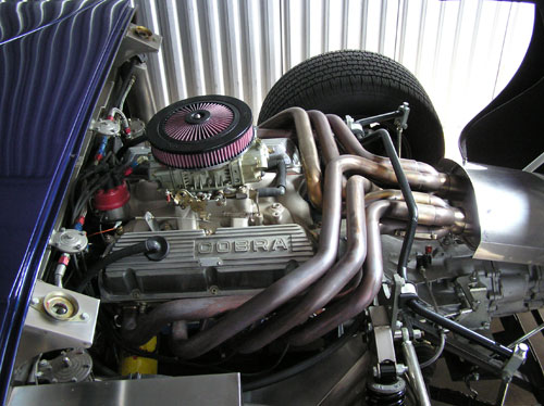

I have just fitted a Renault 21T gearbox to a CAV, a little antiquated you may think, but the GTD racers in the UK have developed and raced them for years and useing up to 450 hp. The Renault installation simplifies a lot of the problems experienced with the Audi, has better ratios, and fits the chassis much better, allowing for the necessary chassis cross member under the box. Frank
