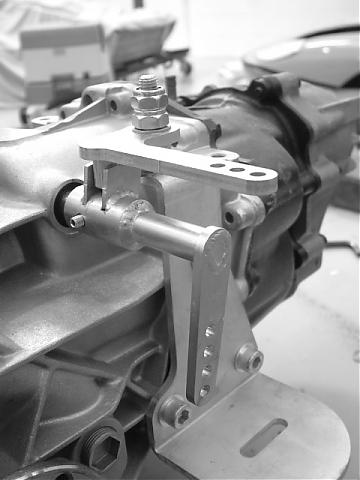

Can someone post a picture of the linkage and mounts used for 016 on a CAV.
I'm trying to figure out what Audi linkage and mountsI can get rid of.
TIA
If you look at Neals build site you'll see the Toyota shifter he used...
and NOT the Fiero shifter seen in the Lambo Lounge.
I believe Neal referred to the Lambo Lounge photos to show the tranny
end (custom made) parts he used.
Rich...trash it all from the 016...nothing gets reused except the slave
cylinder....and you're better off buying a new one.
You will need a special fitting to adapt the cylinder over to AN hose.
I got mine from Pegasus...but others sell as well.
MikeD
Hi Tai
I have all the photos on file. I will try and post some here, but feel free to contact me on [email protected] if you need further information
Jean
