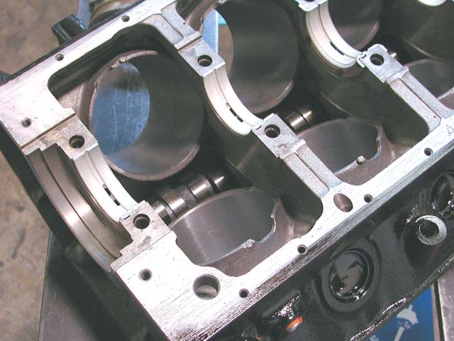

This was lifted from the web (Ford stroker crank instructions), I think very minimum -
"Mock-up the block and crank with a rod and piston assembly to locate areas that require notches for rod bolt clearance. Grind notches to provide .050" minimum clearance."
Here is an image also of a 347 (Also lifted from the web). The 331 should not be as bad, but is has been a while since I have seen the 331.
