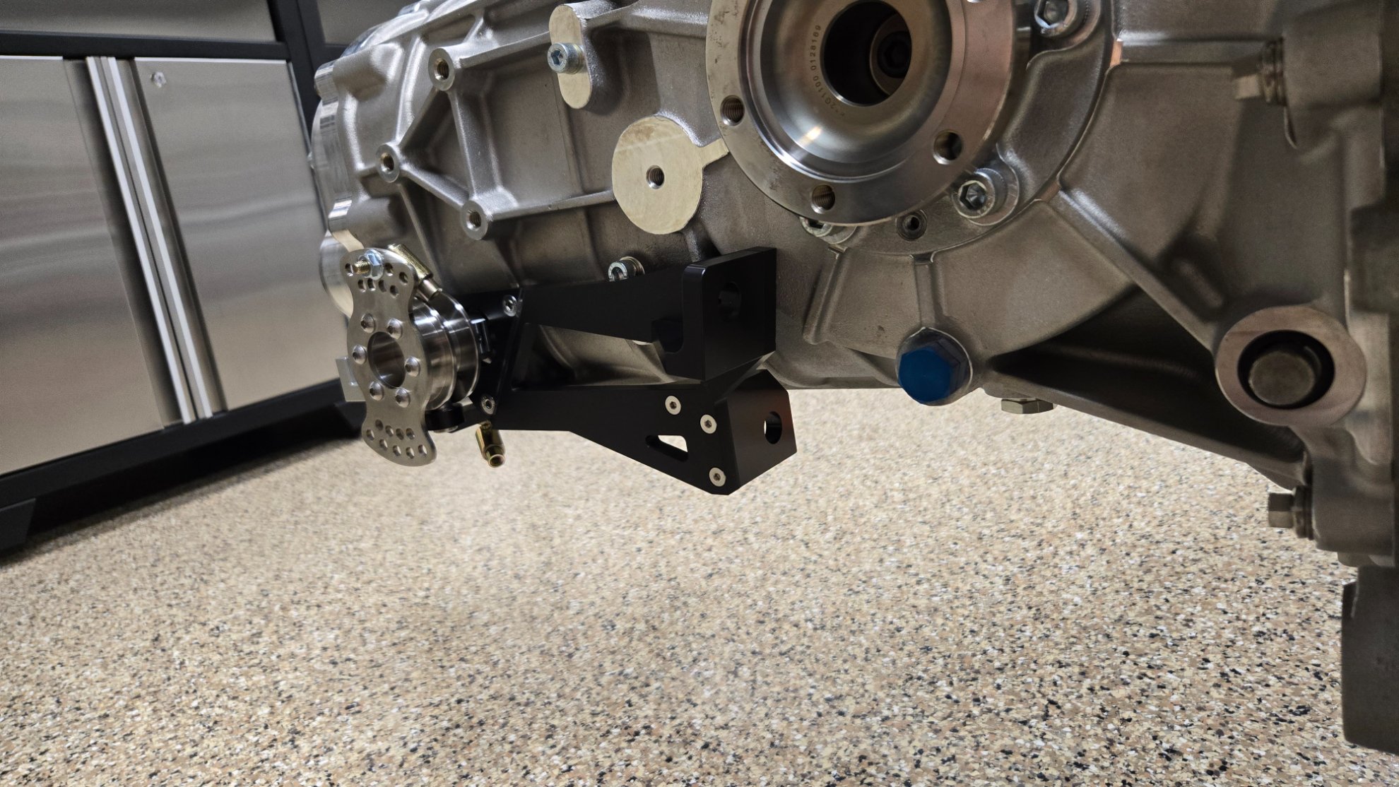

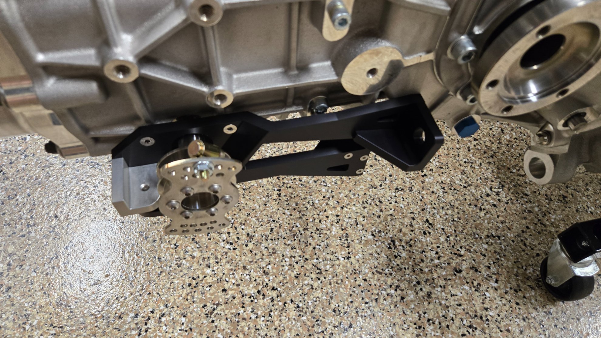

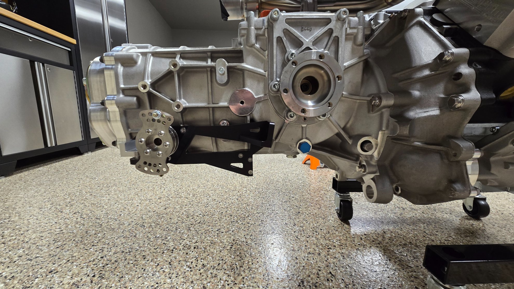

Just wanted to post pictures of this CNC Performance Parts Quaife shifter I installed last night. Me and several others had asked for a version of this assembly that they offer for the ZF. The unit is very well built, compact and easy to install. I'm very glad to have a better solution with greater adjustability than what is currently on the market.
Thought I share for those who may be in need....

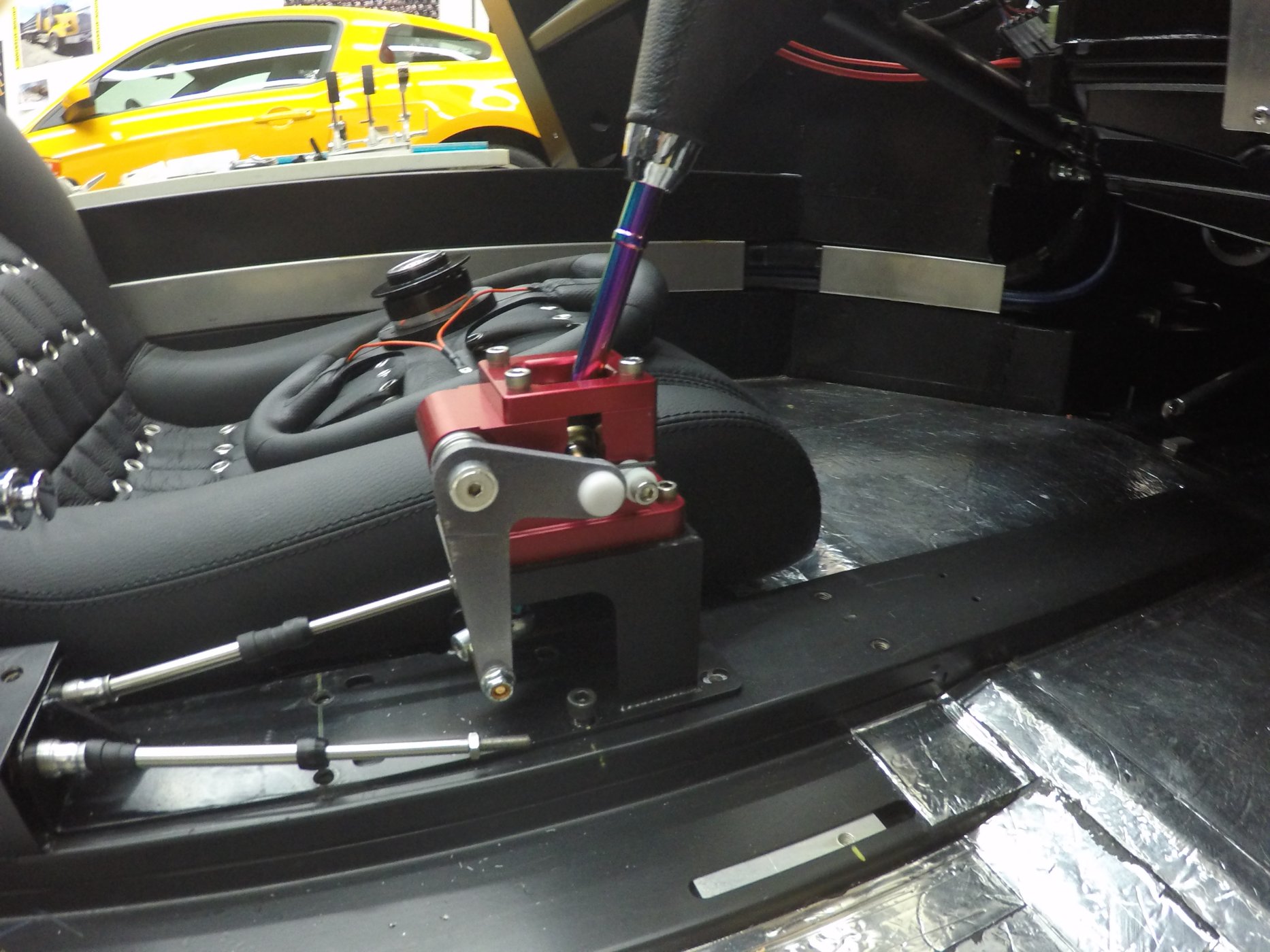

I don't think you will be disappointed with that product. I recently installed both the CNC Adapter & Shifter on my ZF. Really nice stuff! Also got new cables from www.controlcables.com. All in all, fairly expensive, but a significant difference in how much easier the car shifts. Wife agrees. However, please note that, with this combination, there was a minor change to the shift pattern from the RCR package.

Do you remember which cables you used? How did the shift pattern change? Thanks

Here are the cables I used with my RBT in case it helps:

I used the same cables that bryant used. Just make sure of the length you need as your shifter location may not be the same front to rear as ours.
1st & reverse are opposite what they were with the RCR setup. Normal 2-3-4-5 'H' pattern afterwards.
