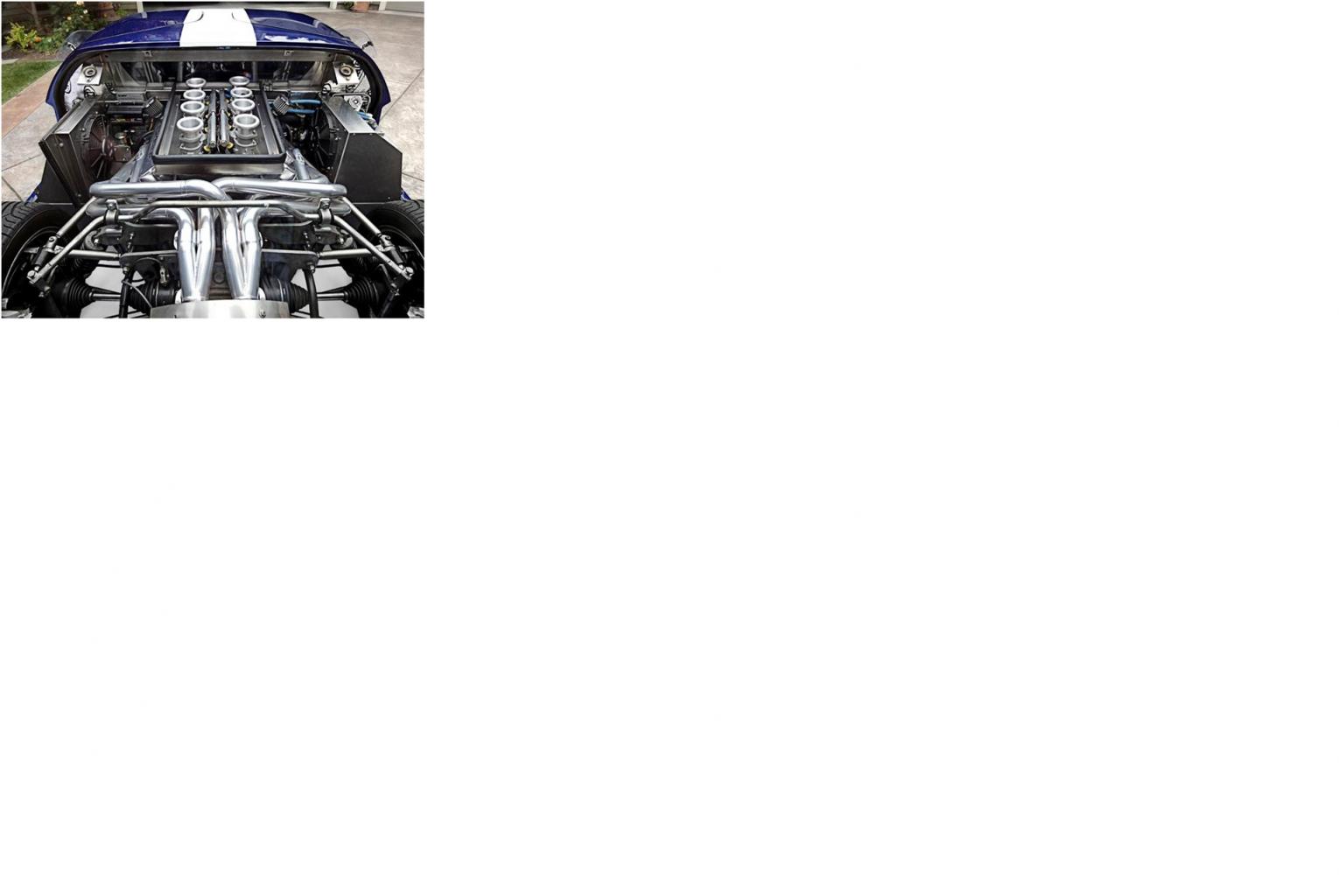

I have seen it placed in the engine bay area next to the side air inlet. The first time I saw it was on Cliff Beer's CAV. It might be a common place for CAV, I don't know. You could shroud the path from the side air inlet to the condenser and put a fan on the back side of the condenser. I have actually thought of doing this myself. It would put more heat in the engine bay area but it would also would have air flow in that area that would help removing heat.
On a production vehicle, the compressor is in the front and the condenser is also in the front close to the compressor. If we put the condenser in the engine bay of a GT40, it too would be close to the compressor and would avoid running the high pressure hot lines from the engine to the front through the tunnel. If the condenser was in the engine bay, then we would just be passing cooler Freon to the evaporator through the tunnel.
The condenser up front would have the best air flow and heat transfer for the condenser itsel, but mounting in the engine bay might be ok as well. Street cars don't have the same opportunity of the rear engine and side air vent. <o:p></o:p>

Bob Woods<o:p></o:p>
