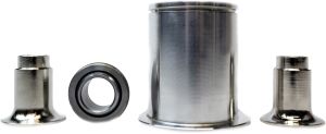

3. The poly bushings are great for street driving but you would want to upgrade to poly bushings vs spherical bushings for track driving.

Sorry, I meant swap out the rubber bushings for something firmer.
