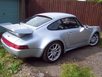

I have nearly completed my Porsche replica after 2 years of hard labour,just carpets and general interior tidying to do.The car when i first purchased it was a total mess,doors hanging off,the whole thing rattled badly when i drove it home,i dont know how it got an mot by the previous owner.
The fuel pipes were pumbed in using nylon braided garden hose and the rest of the car was up to the same standard.
Sent a picture if anyone is interested,its powered by a ford v6 2.8i which is a baby compared to your engines and i know most folks on here are gt40 but for me this is my dream. /ubbthreads/images/graemlins/smirk.gif

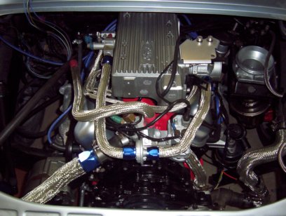

It looks really professional, did you do any mods to the engine. What transaxle does it use?
I run a mid engine Essex V6 in my AC3000 with twin turbo's on it.

Hi
The engine at the moment is stock but was in such good condition when i got it (in parts)it was re-bored and was all completely cleaned,the chap i got it off used it for up hill racing.I had to do mods to the airflow box,getting rid of the large plastic filter housing and fixing in a flat plate to a 76mm pipe for a cone filter to save space.I have also fitted the steel timing gear from quaife engineering,better to be save than sorry.I am looking into a turbo conversion at the moment,but not sure the tranaxle will cope.Its an uprated vw type 3 gearbox with altered ratio but is only good for around 200 Hp.The car only weighs in at 825 kgs so the power to weight is ok,i need to add some weight to the front though.It uses 944 brakess,driveshafts and A arms,Avo adjustable coilovers.Its sitting on the Covin chassis,not the vw floorpan.
I bet yours shifts with twins on it.Around 280 Hp i bet.

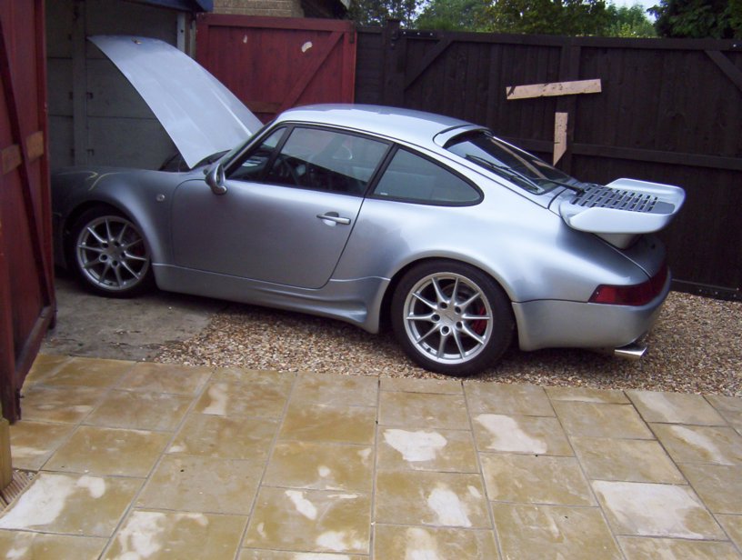

The colour is Porsche Polar Silver,i bet a 40 would look a bit special done in this colour,theres a very slight pearl in it and seams to change with the light.
