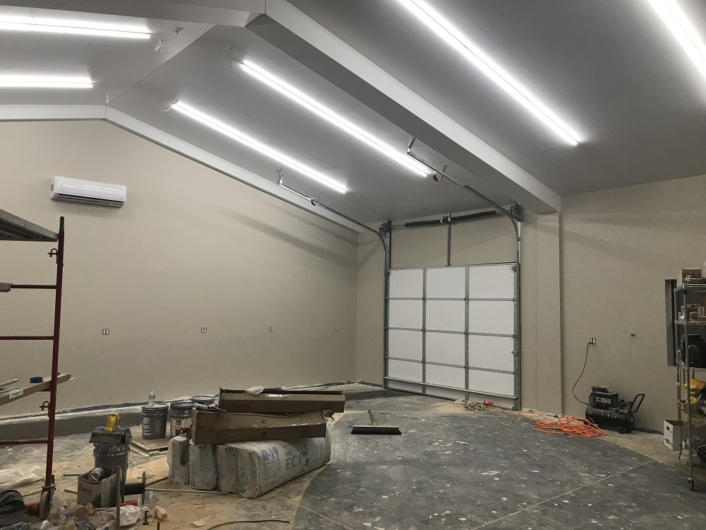

I recently built a 38x46 metal building, 12' eve height. On one end, a 12x12 office and 12x12 cubby (corner of the building to the office in the middle) with a mezzanine over both. I have a wall fan in the cubby for dirty work like the CNC plasma table, sand blast cabinet and little powder coat setup.
A 2 ton minisplit keeps it cool in the summer and warm enough in the winter, but I would like to add a waste oil burner, but more for old fuel and oil disposal than heat.
It's all sheetrocked and well insulated.

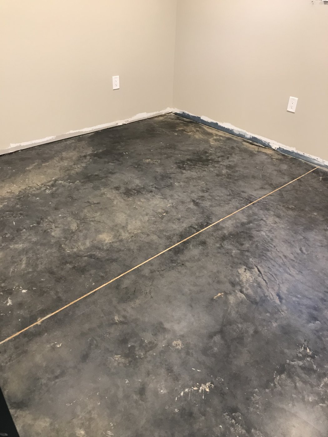

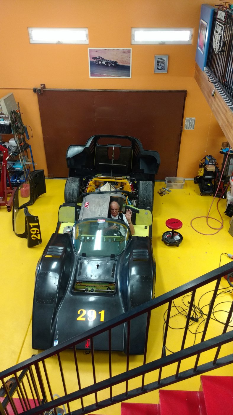

Here's something I thing I did that was inexpensive and very functional. For the floor, when they were troweling the concrete, they added black pigment powder into the "butter" and just troweled it in. Only cost a few hundered dollars for the material and left a nice mottled darg grey finish. After construction, I scrubbed the floor and used a penetrating sealer. Here's a pic of the finished product before adding the 1x6 deck boards for base. Oil and antifreeze just bead up.
Middle bay has a 2 post lift and a 72" ceiling fan.

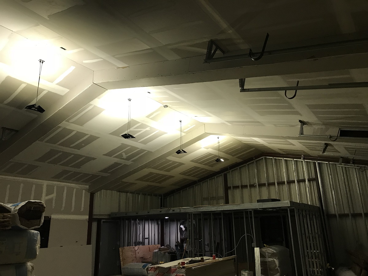

Ebay has very inexpensive LED lights. With the rapid inprovement in lighting and falling prices, I decided rather than spend big money on light fixtures, I ran a string of outlets on the ceiling for easy replacement and upgrading of lighting, but I doubt I ever will need to.
I don't see the ones I bought, but I have 3x3x6 lights very similar to these and it's bright as day. https://www.ebay.com/itm/3034994878...R4KN4IfAgf5qKAYzg%3D|ampid:PL_CLK|clp:2047675

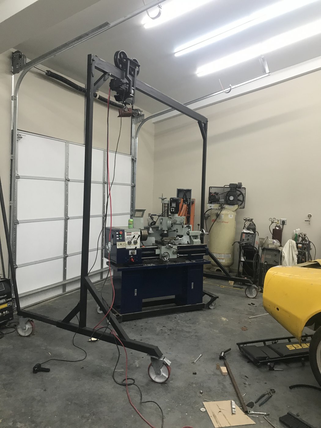

The overhead lift point is a good idea. Instead of dealing with the metal building designer, I made a small gantry crane. Wheels on one side are telescopic. With it collapsed, it fits fairly tight to the wall straddling a work bench, so it takes very little room. I successfully lifted my little 1800 lb lathe out of the back of my truck as well as standing up the post on my 2 post lift and putting numerous engines into and out of the bed of my truck.

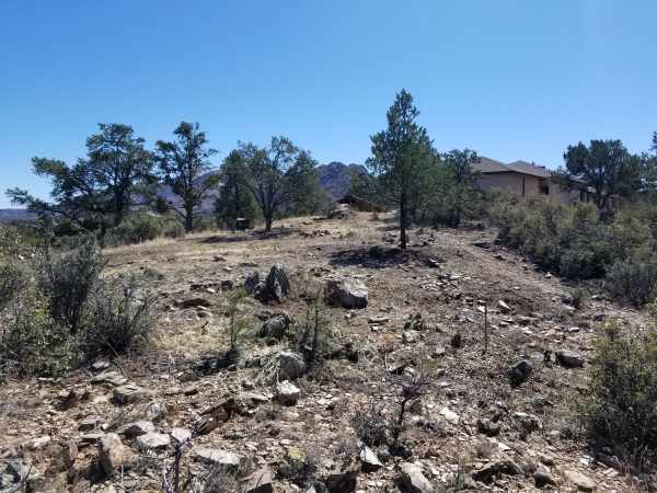

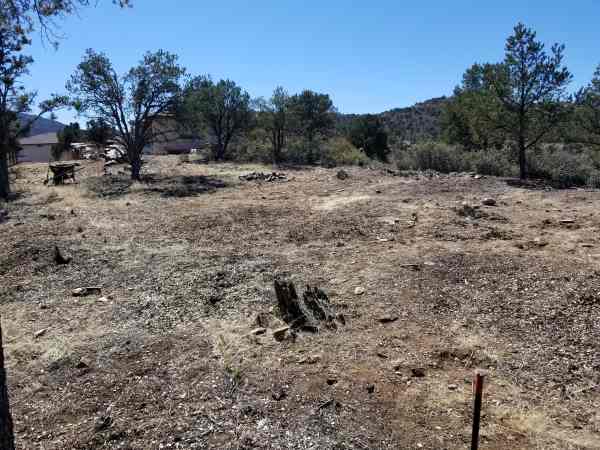

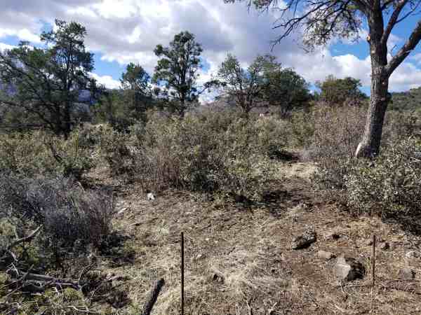

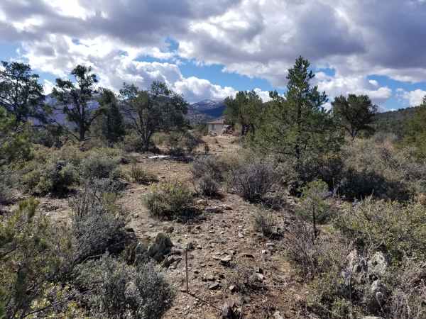

Here's some pictures of the intended build site. It's a ridge line with mostly shale rock strikes and one rock strike band that's most likely granite/quartz mix. It's got a slight slope where the highest corner is about 2.5 feet higher than lowest corner. I plan to shave the ridge peak off and use the soil/rock to fill the lowest corner.
Lowest corner looking looking to highest corner prior to brush removal.

Second lowest corner before brush removal.

Lowest corner after brush removal.

Second lowest corner after brush removal.

Looks like a nice build site. Will this be a slab on grade or a footing and wall foundation. In my area we must go 4 feet into the ground to get below frost.

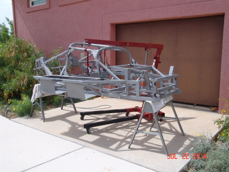

For me, extending the mezzanine across the top of the door is going to be an issue as it will limit the door style that can be used. The mezzanine will need to be cantilevered within the structure. Also trying to get the door high enough to drive a decent sized vehicle in is also a concern. If I want to get something high in down the track, a low height roller door is not going to be my friend.
Use a roll-up door instead of an old-style single-leaf garage door. All benefits and no downside except the additional cost.
... or a sliding "barn door". No problems taking up overhead space. Here is what those look like:
