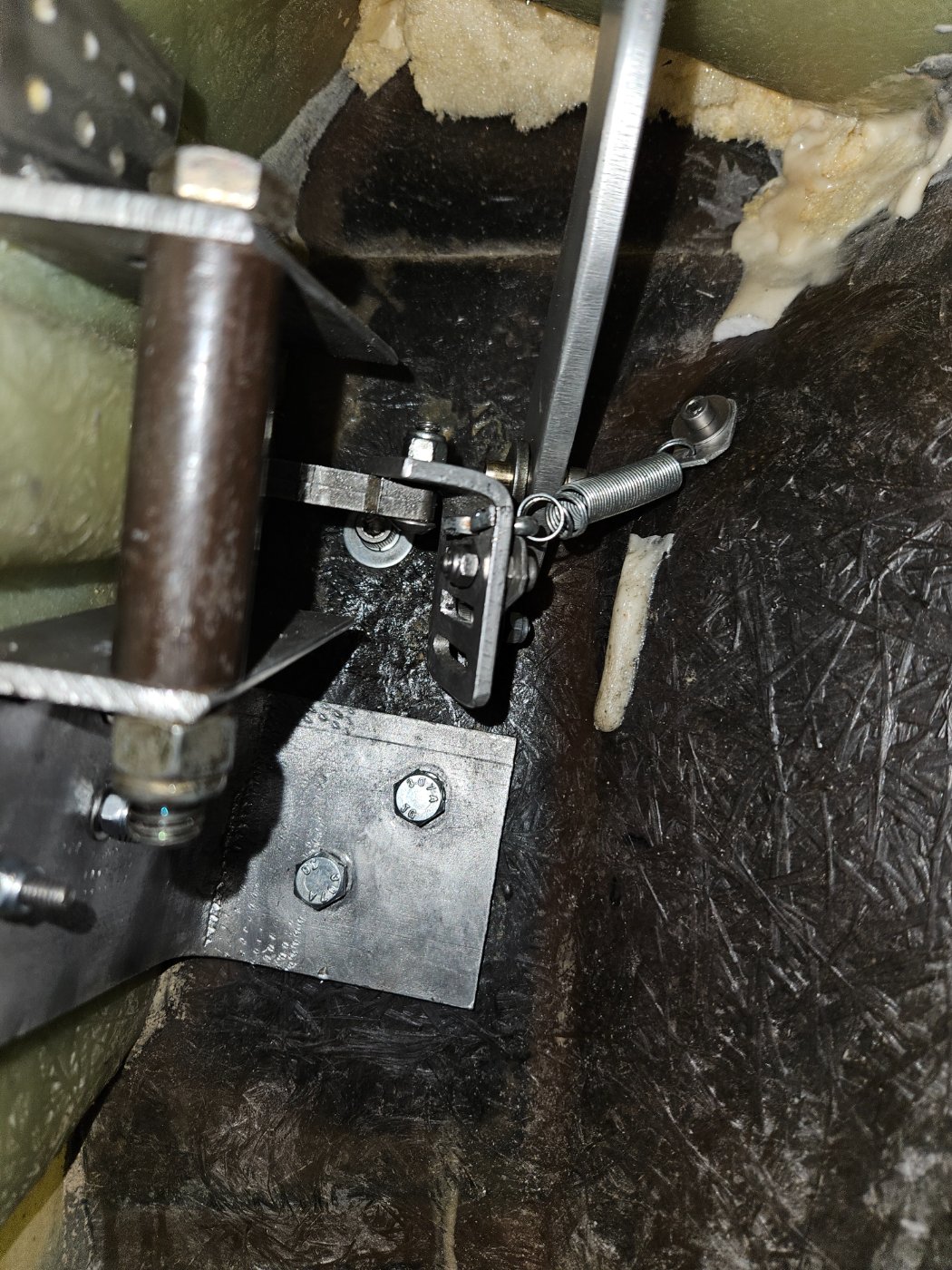

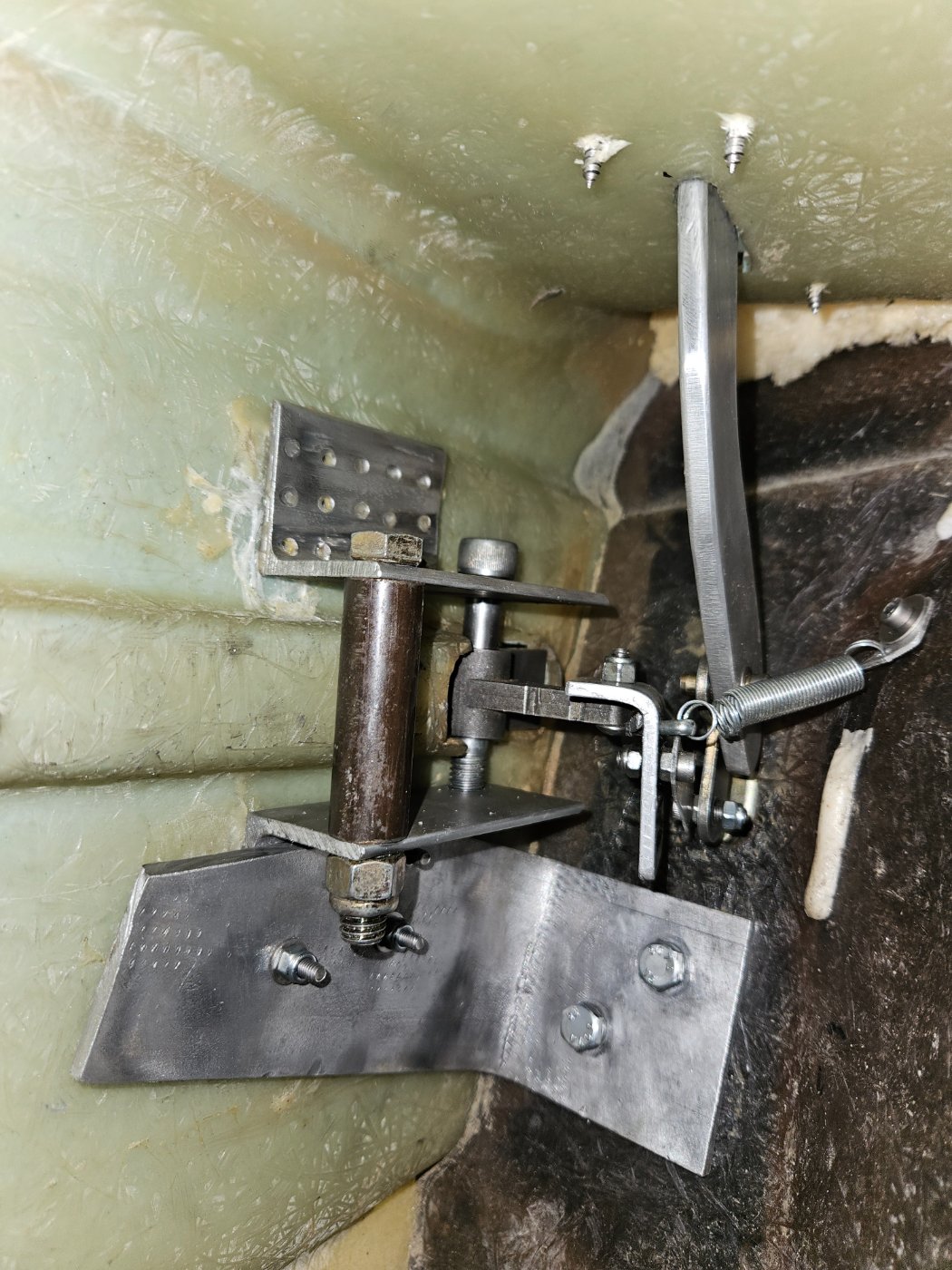

The inner handle bolts on the mechanism directly and the outer one has a cable that does the pulling. The 2 springs return those inner/outer handles respectively

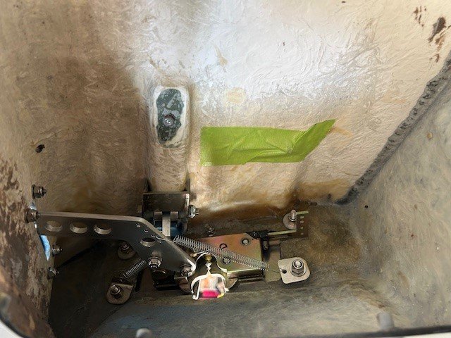

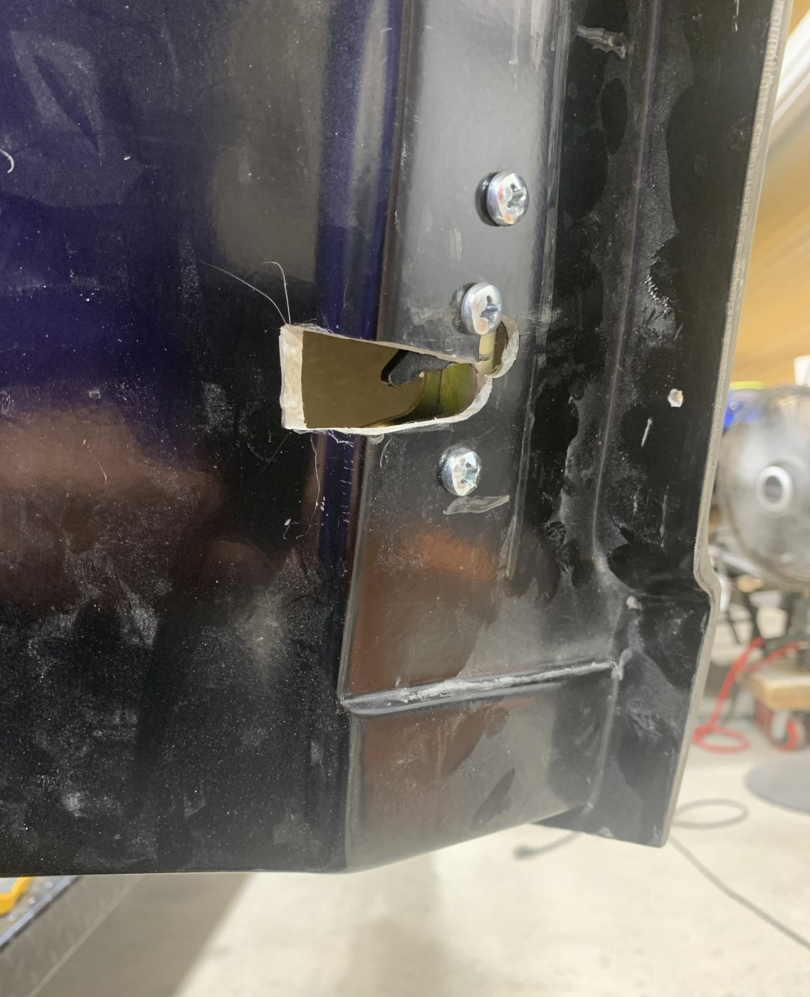

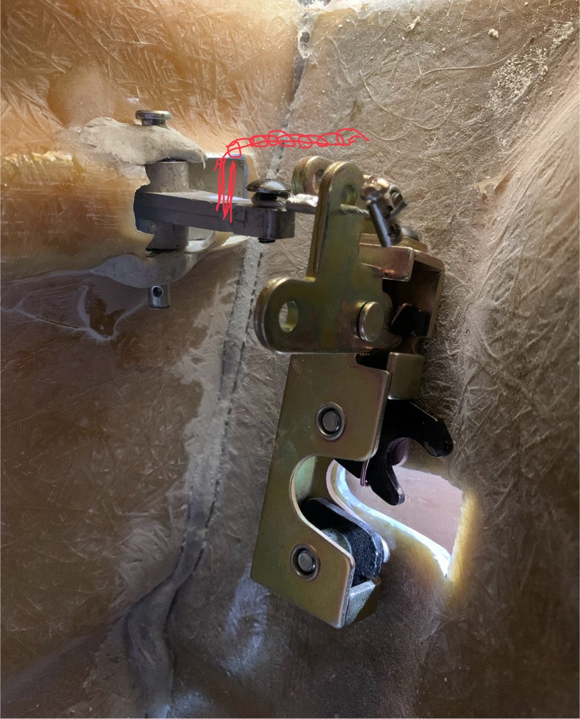

Paul, sorry…I thought I had posted about this some time ago but will go back and see or add it in the next couple updates if not. Here is a couple pics that I did find in my files. Unfortunately I don’t have the exact one with the spring but drew it into the position that I found will work on my handles to retract it into place. As you can imagine each spring rate and length/strength will vary on how it “snaps” back into place. I have added door lock tumblers since this pic to prevent the outside handle from actuating and will be working the opener/release mechanism from the inside. Two choices 1) release tab at the top, like SPR replicas 2) have a release cable pull, like a classic mini cooper
