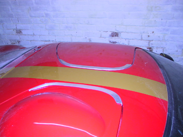

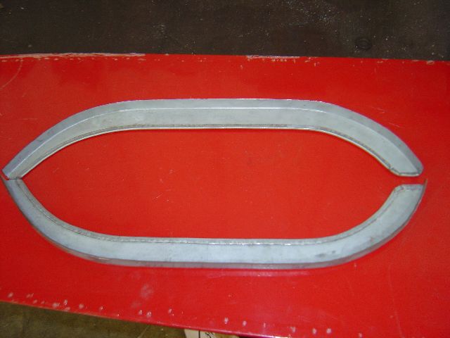

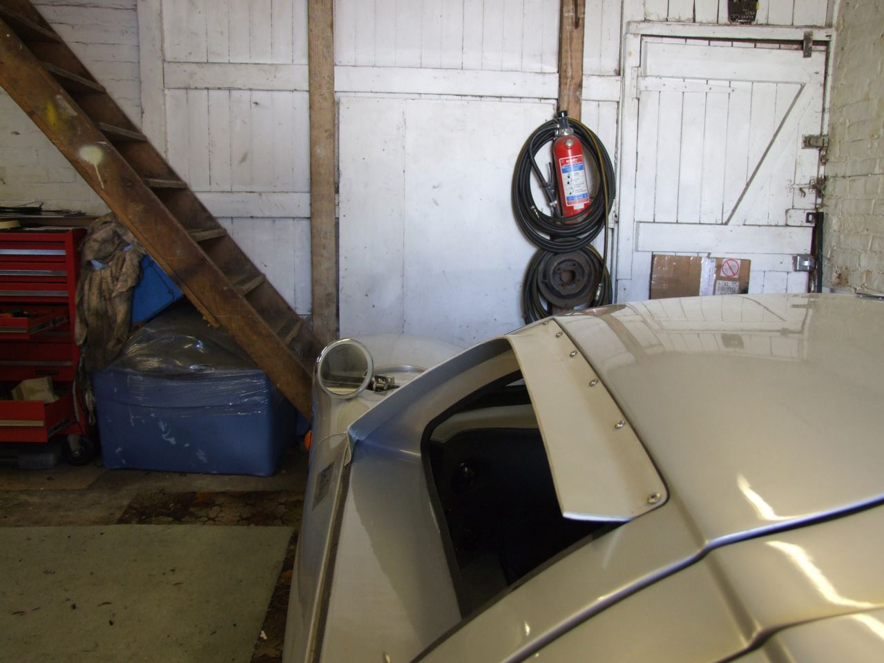

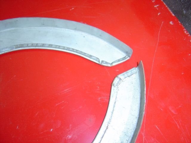

Do you mean these, or these ?

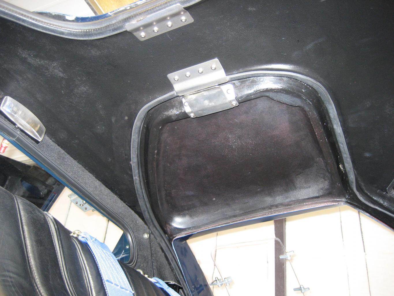

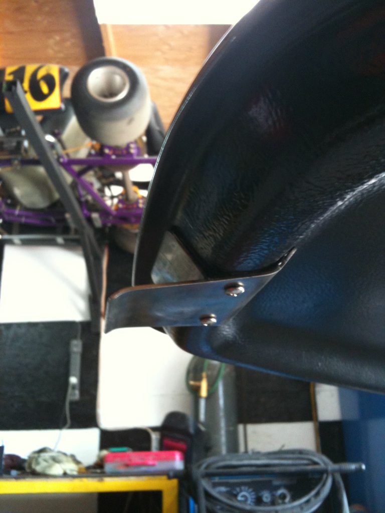

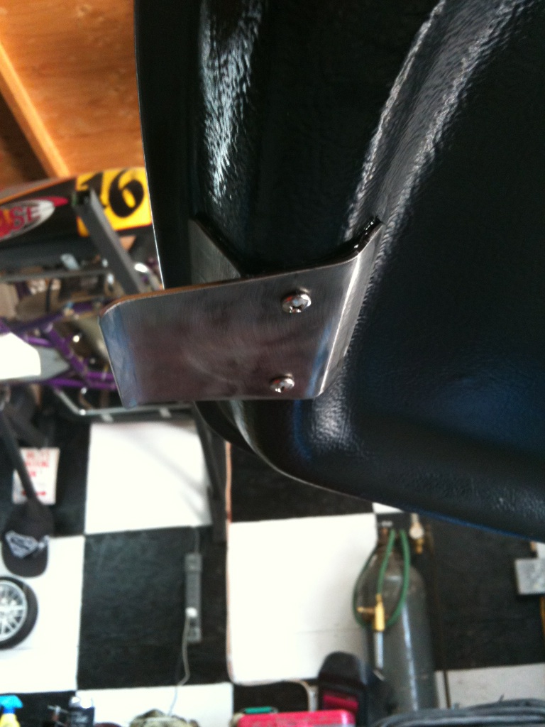

Here's what I did to eliminate the eyebrows installed on the outside. Sorry, I only have pics of the door attachment which may be a bit hard to see but I attached a set of mating slide plates to the interior, one on the door and one on the spider. If you'd like more pics I can shoot them.

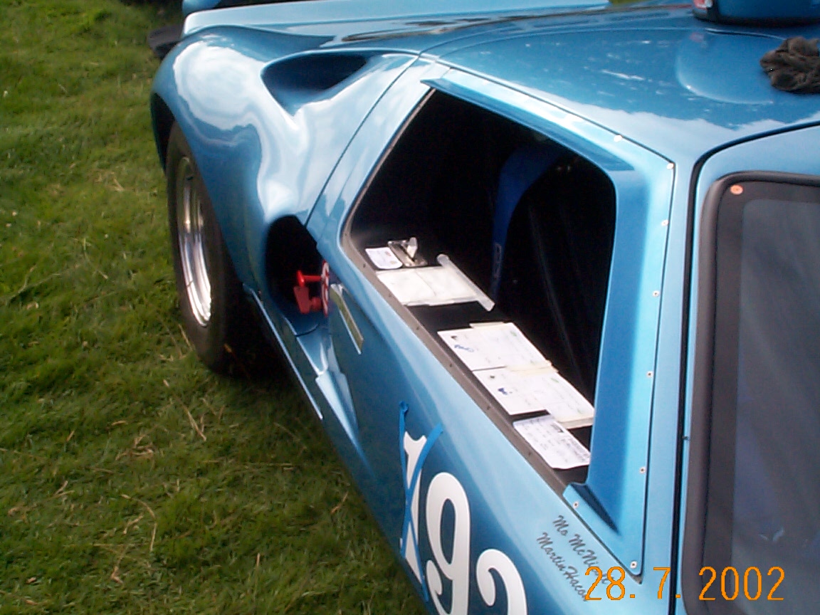

Here are a couple of pics which may help. If you just fit the "eyebrows" then because the top of the door is flat the rubber seals push the door up so when it is shut the edges catch and can scratch and chip the paint. Also at very high speed the car acts like a wing with low pressure over the roof which causes the door tops to lift. It has been known for the plastic type of eyebrows to break off and the door top to be pulled open - very scary! Fairly substantial aluminium ones are available which are better
The best solution even if you use the eyebrows is to use the stainless steel clips on the spider centre and on the door inners which pull the door down and hold it firmly in place. This also helps a lot in keeping the rain out. I have them on my GTD and they do the job well.
Mike Pass
Oops! Brain fade.Senior moment again. Here is the correct pic for the stainless steel clips.

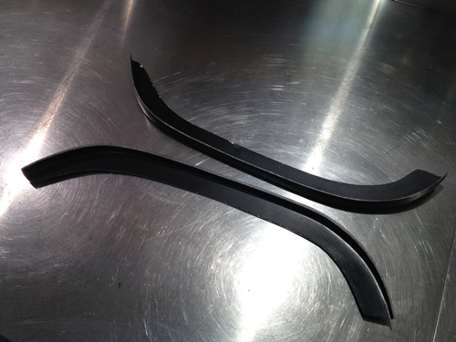

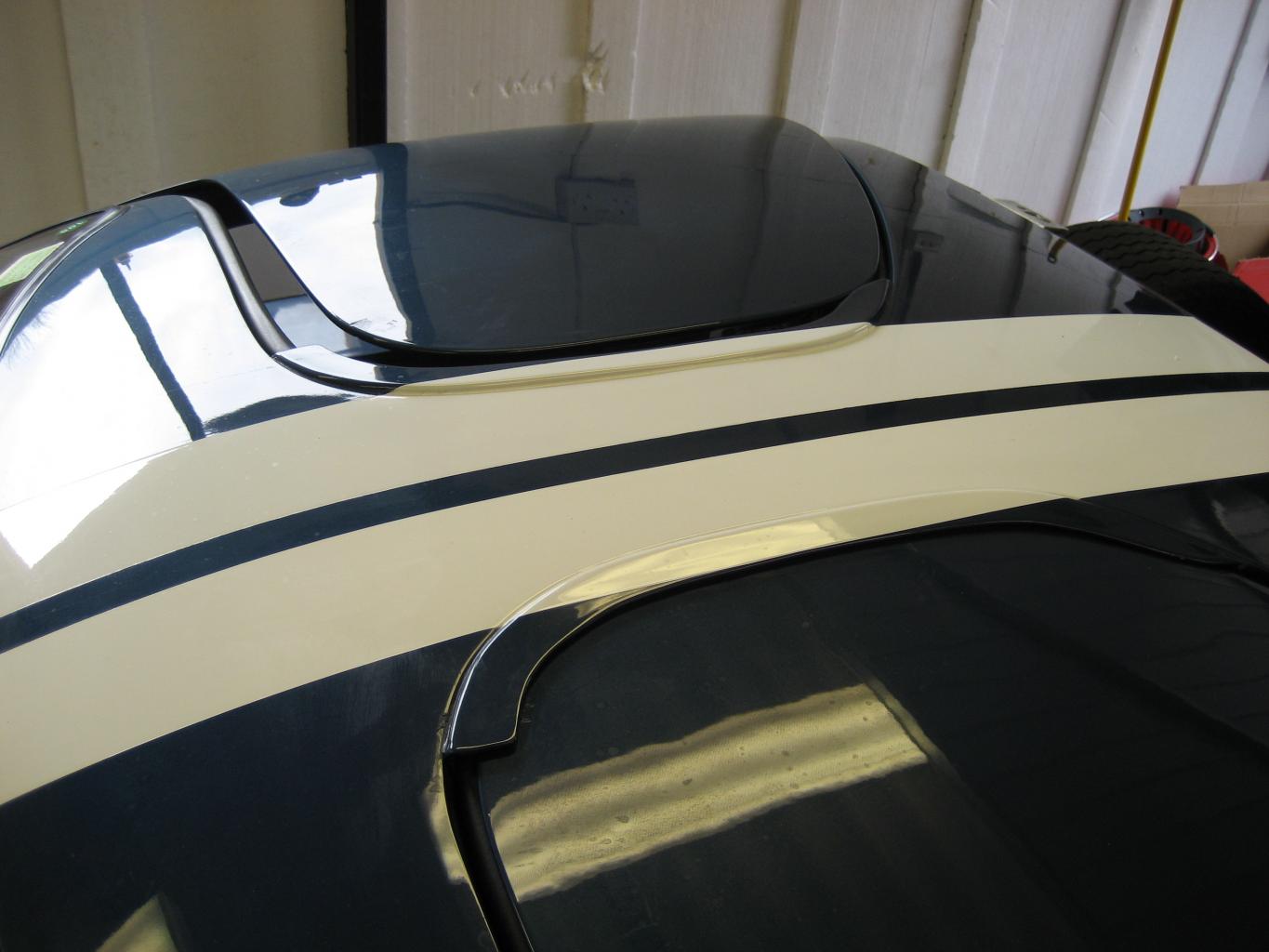

Below you'll find two pics of original NOS eyebrows found on this forum :http://www.gt40s.com/forum/gt40-tech-exterior-interior-ac-trim/25082-eyebrows-needed.html
L shaped steel, as you can see.
I was fortunate enough to had a very close look to P/1078 (Mr Nahum's car) two months ago, and I could notice that the top of the doors have a thin recess the exact shape of the eyebrows, thus allowing a good fit and no rubbing (and the eyebrows could be then set "low profile")...sorry, was mesmerized by this car, didn't even think to use the camera hanging on my chest.
Don't know if that was period correct, but seems a nice and elegant solution to the usual issue.

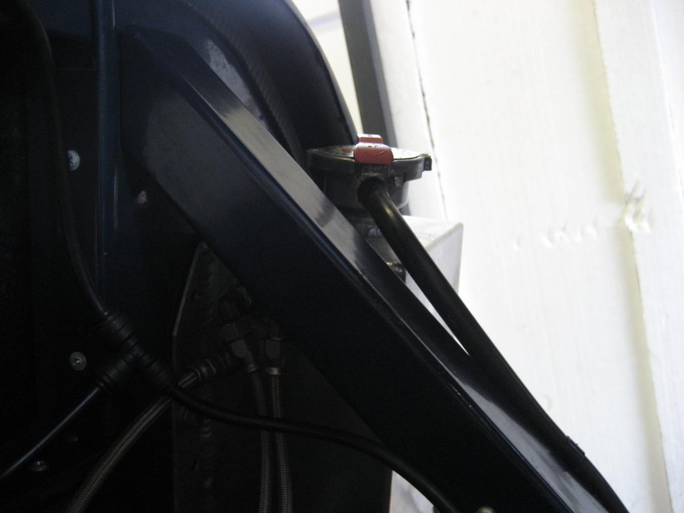

Quite right Mike, 192 in fact, and no problem at all with door lift. My car uses the aluminium eyebrows as supplied by Southern GT with, as Mike suggested, a thin strip of helicopter tape to prevent scratching. It's simple and works a treat!
