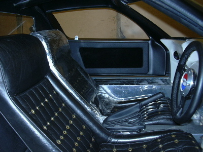

Did mine with 5mm plywood frames, then put in rivnuts into the wood and just pop a m4 allen head bolt in from the inside of the door pocket out. Once you know it fits ok you can cover the outside with foam/trim and they are easily removable. I also put a piece of angled ally along the bottom edge so that there isn't too much flex when you pull on it - negating the need for a door handle.

Paul, that sounds like a good approach. Did you put the riv-nuts in from the door-side of the ply ? Also, my only experience with riv-nuts has been with the ones that lock into fairly thin sheet metal - did you use these & just rely on the nut body squeezing out into the ply & locking it in ?

You can get rivnuts that will go into softer material, I have all the tools for rivnuts if you need it. A good place to get them from is Aerobolt at Chipping Norton, if you are using the standard nuts I have them.
