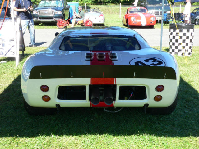

Since I need to re-paint my car does anyone know what kind of lights were used by the earlier Mk I? I want to install the pair used at that time but don't have much info as to what make they were etc..?
Any push in the right direction would be appriciated.
Chris
they were uk sourced rear lights, so very unlikely to be corvair lights.
I would look to Land Rover rear lights as a starter.
Are the lenses flat or domed ?
are they held in with 2 or 3 screws, or a push in chrome ring ?
what diameter are they ?

Chris,
Having spent dozens of hours sourcing my early lights, IMHO i feel i can provide the correct answer.
In fact, there were an even earlier style of light fitted, than the one you posted a photograph of. If you check out photos of the prototype cars you will see what i mean.
In your photograph the lights are Lucas units, model numbers
Amber Unit & Red Unit: L691
These are the same units as fitted for turn and stop, to Austin Healey 3000.
You can find these units, remanufactured on eBay quite often.
They are also available at
www.holden.co.uk
where you will find an impressive supply of remanufactured Lucas parts.
Do a search on Holden's site using L691.
Hope that helps.

Tom - this pic is only used as a reference so people know what the heck I'm talking about - this is chassis 1043 hence not my Mk I but I do remember there was a couple of threads regarding the rear spoiler, try the CAV forum, I think one of the Gulf cars had one.

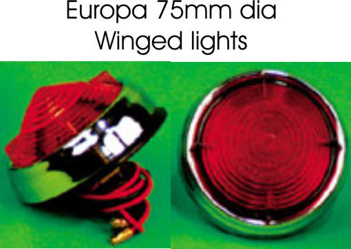

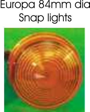

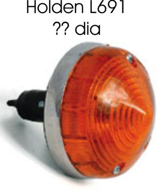

Thanks Chris, Charely - The Europa website lists both amber and red stop lights in snaplight @ 84mm dia and winged at 75mm dia. The Holden units don't post the dia on the site.
Not sure which ones are correct?
Chris
