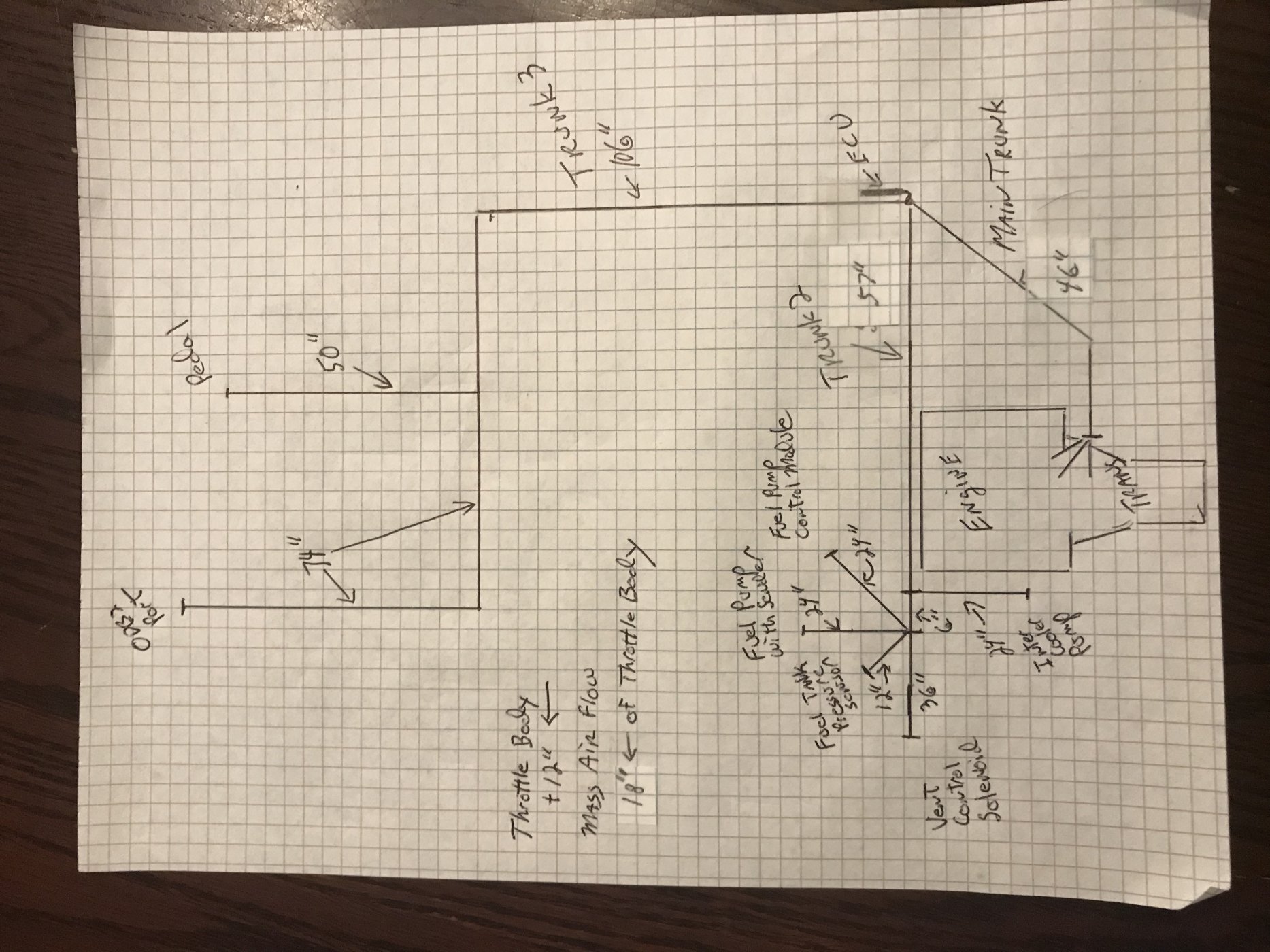

Well they have a standard layout, but I wanted things layed out in specific places so I drew out a diagram and they followed it. Ask for Justin and be clear you want full emissions.

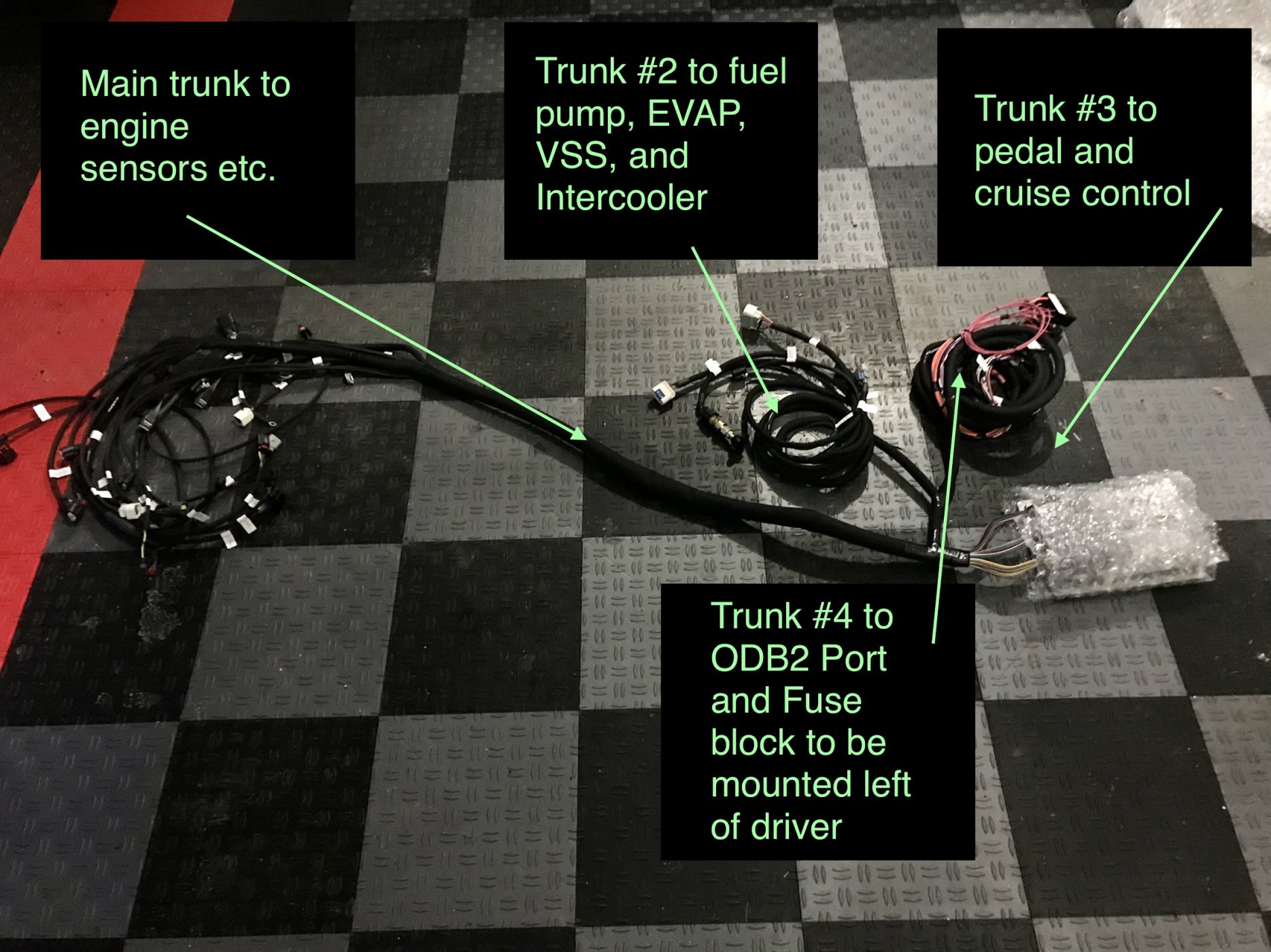

Here is my diagram for an LT4, some of my branches are too long but better than too short...
Here is the harness…
Would you mind sharing your order # via PM? I can forward that and my engine info to Speartech to give them a starting point. Just subtract the intercooler/turbo related sensors. No reason to reinvent the wheel, and definitely agreed too long is better. Can't cut it longer.
