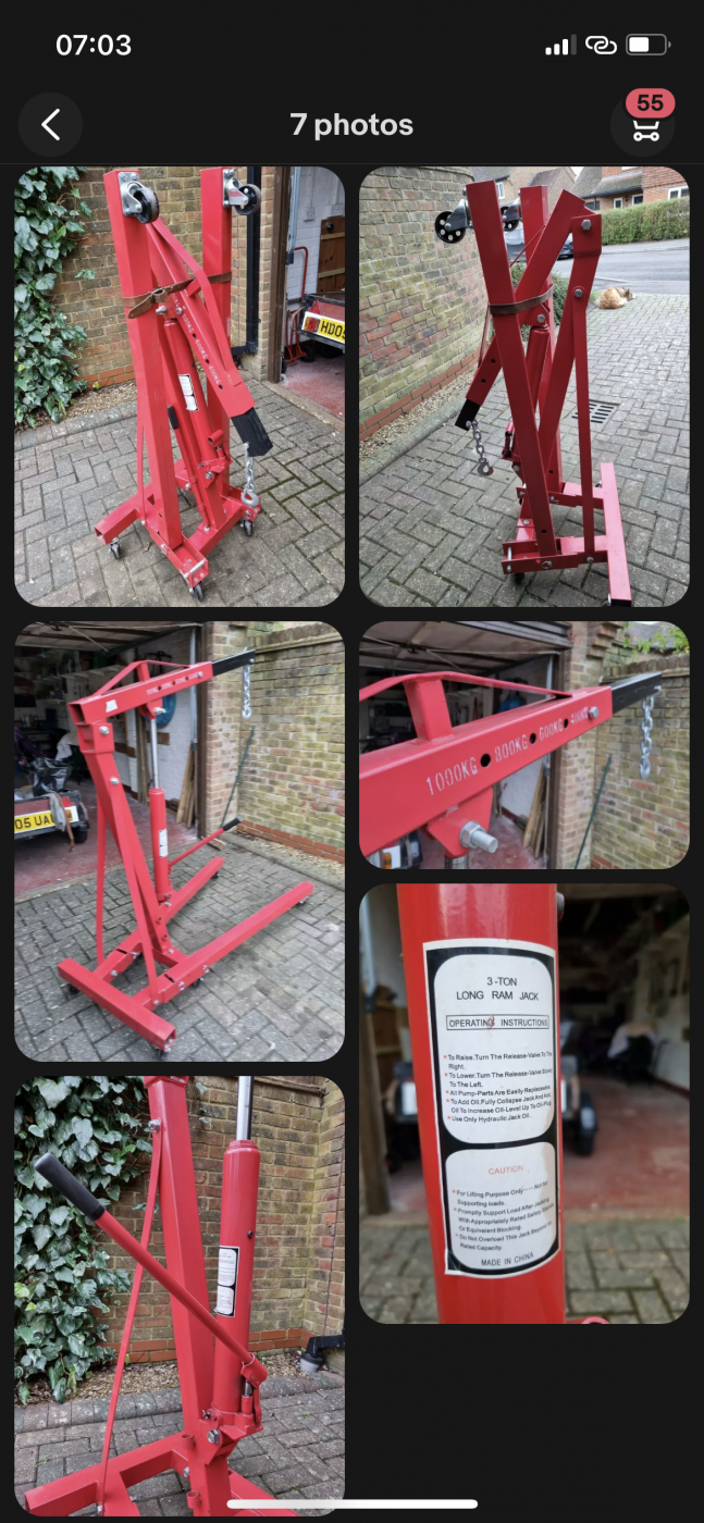

Biggest load is always better. I’ve just bought a 2 ton folding crane from eBay for £170 and picked up a decent unused engine stand from FB marketplace for £20! They’ll both take more than I’ll ever need but you never know!
Plenty around
Simon

Check that the arm is long enough. It is a long way from the back of the car to the centre of the engine bay. Get a strong one as 400+lbs bouncing around at the end of a long arm is not helpful. The bare block weighs about 150 pounds.

When checking the weight capacity of the engine hoist, make sure it's for full extension.

Another solution is a chainblock in a tree or in the rafters. Hoist engine, and roll the car underneath and drop the engine in:)
otherwise a 2 ton engine hoist, fully extended lifts 400kg.
